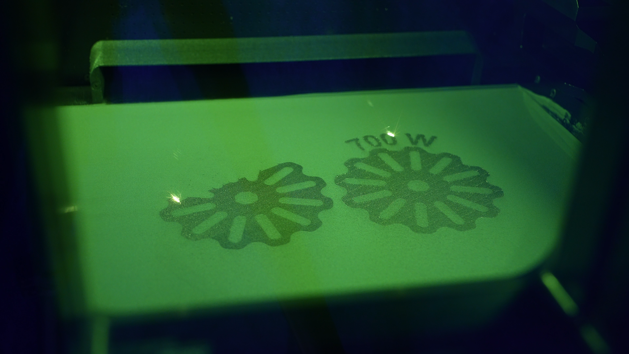

Two 700-watt lasers
The TruPrint 3000 prints with two 700-watt lasers. (Image: TRUMPF)
