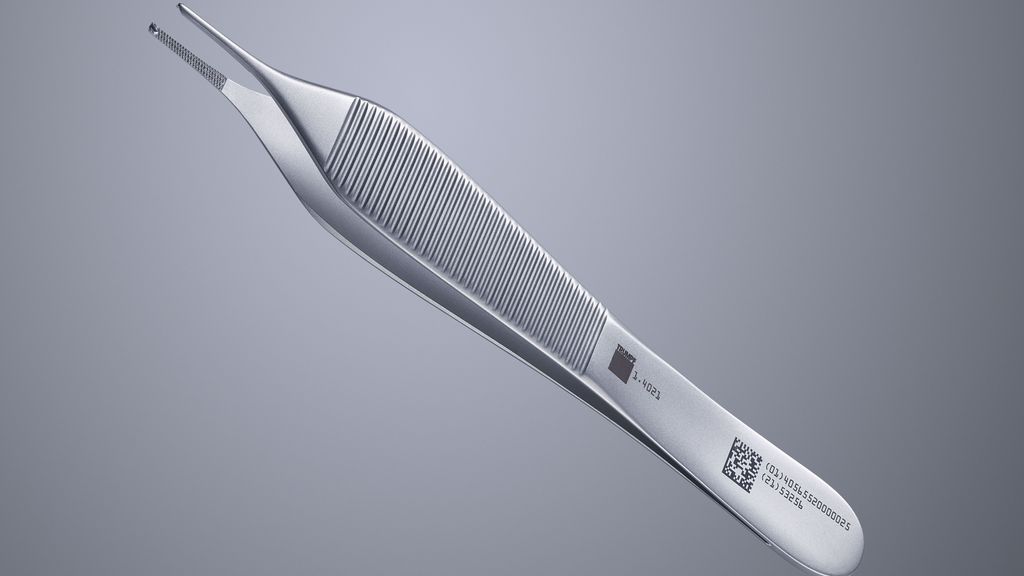

Black marking is a procedure in laser processing which causes extremely dark, high-contrast markings on a surface without material ablation.

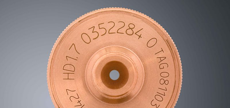

Laser marking of copper
Copper - a key material for many industries, but highly reflective and therefore not easy to process. Find out here how high-quality markings and engravings on copper can be achieved using lasers.

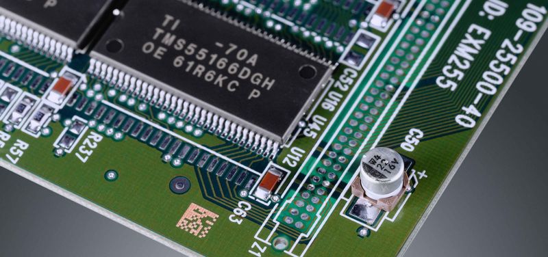

Laser marking of electronic components
The laser's properties make it ideal for marking the smallest and most sensitive electronic components. The laser can be used flexibly to permanently mark not only printed circuit boards (PCBs), but also semi-conductors and flame-retardant plastics.

Due to extremely short laser pulses, you can create durable and deep-black markings without damaging the material surface through ablation. The perfect procedure for creating corrosion-resistant markings, for example in the medical technology sector.
