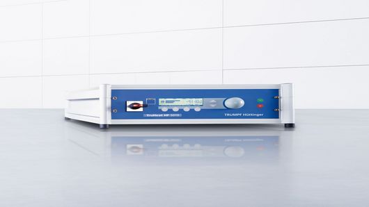

RF generator for induction heating
Inductive process energy without compromise
Due to its compact form and the different available designs, the TruHeat HF Series 1000 / 3000 (H) / 5000 (H) enables easy integration into new, as well as existing systems.
