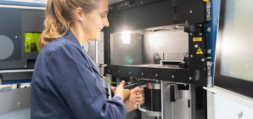

TruPrint 1000, cylinder replacement
Cylinder replacement
We make cylinder replacement as easy as using an espresso machine! The interchangeable build cylinder and storage cylinder significantly increases your productivity and reduces setup times. In the event of a material change or service cases, the build job can be restarted quickly. The supply cylinder can be filled outside of the machine, parallel to production. The entire process also works when the build volume is reduced (build volume: Ø 50 x H 100 mm) when using high-priced materials.
