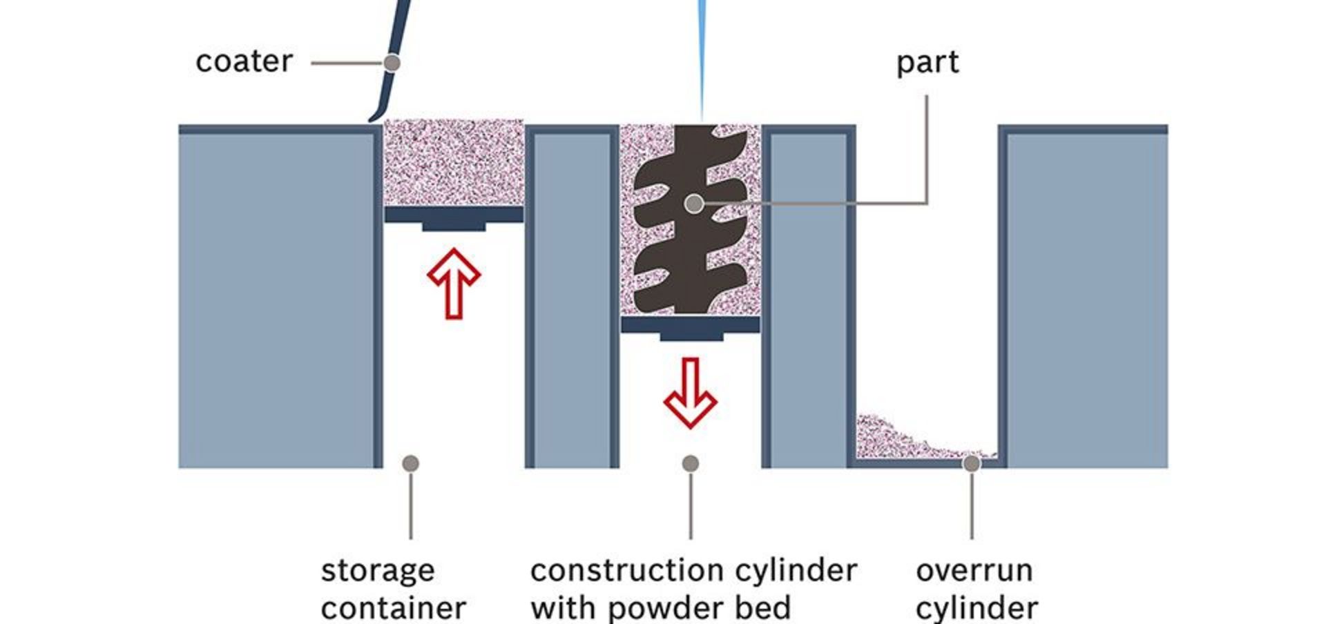

  • Laser metal fusion builds up parts layer by layer in a powder bed. The process takes place in what is called a process chamber.
  • Laser metal fusion essentially works as follows: The supply, construction and overflow cylinders are situated alongside each other in the same axis. A device known as a coater applies powder from the storage cylinder to the construction cylinder.

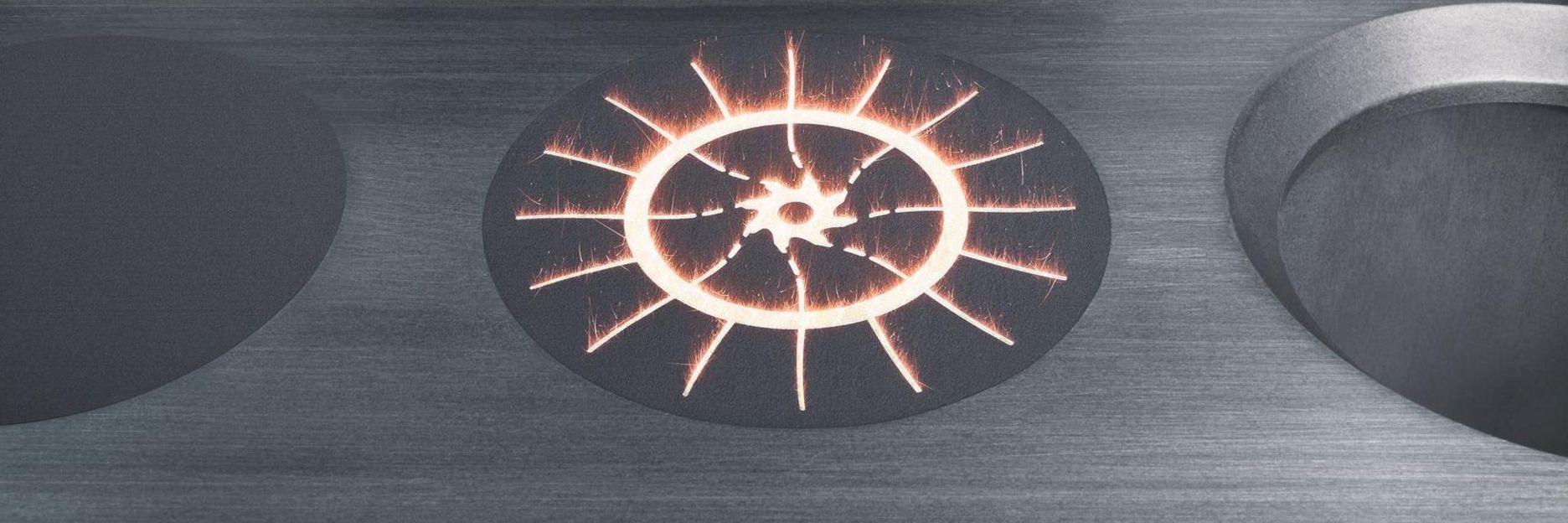

  • The laser then fuses the first layer of powder into the contours required for the part.
  • Next, the construction cylinder moves downward, depositing any excess powder in the overflow cylinder. This process is repeated until the part is complete.

In laser metal fusion, a laser transforms powder into a part by melting it – this long exposure shot makes the process visible.

Functional principle of laser metal fusion.
