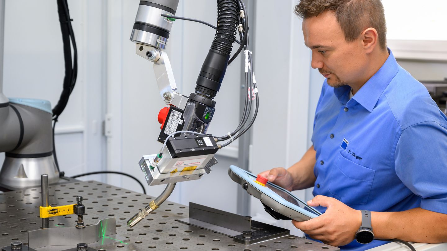

Simple programming
With Smart Seam Tracking, the welding robot can be programmed within seconds, even for complex components. This relieves employees and counteracts the shortage of skilled workers. (Source: TRUMPF)

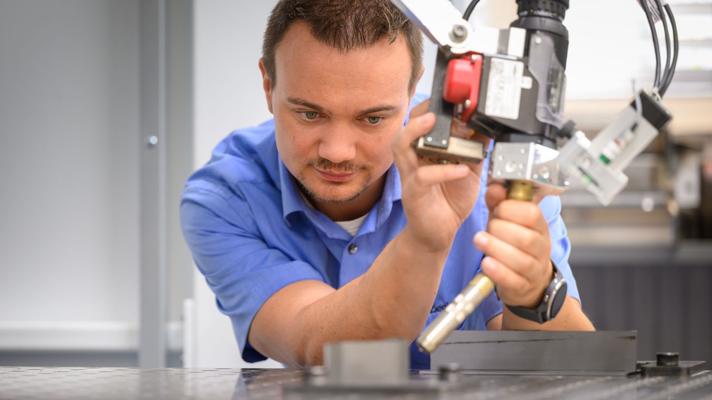

Bringing the robot into the start position
Instead of teaching each welding spot individually, the employee only has to bring the robot into the starting position. The rest is done by the technology. (Source: TRUMPF)
