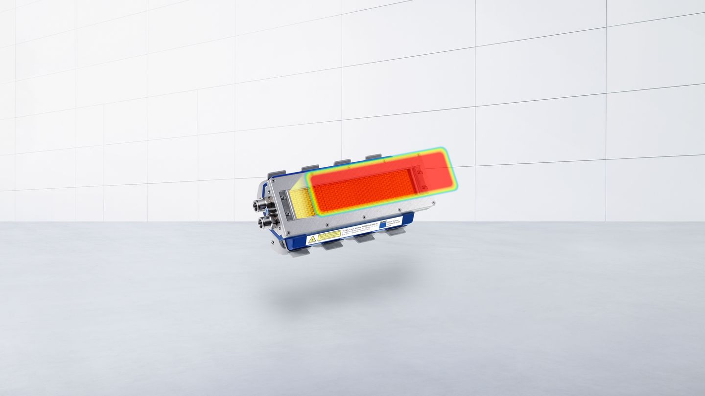

Picture 1
TruHeat VCSEL heating solutions from TRUMPF for Li-battery manufacturing enable more efficient production in various process steps. © TRUMPF

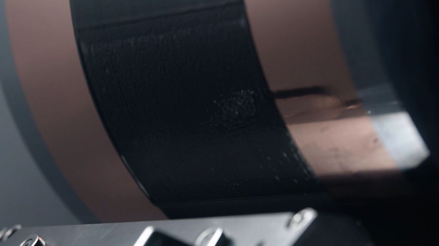

Picture 2
The VCSEL diodes that are used in the VCSEL heating systems are manufactured in the clean room facility at the headquarters of TRUMPF Photonic Components in Ulm. The assembly of the heating modules is done in the Customer Application Center in Aachen. © TRUMPF
