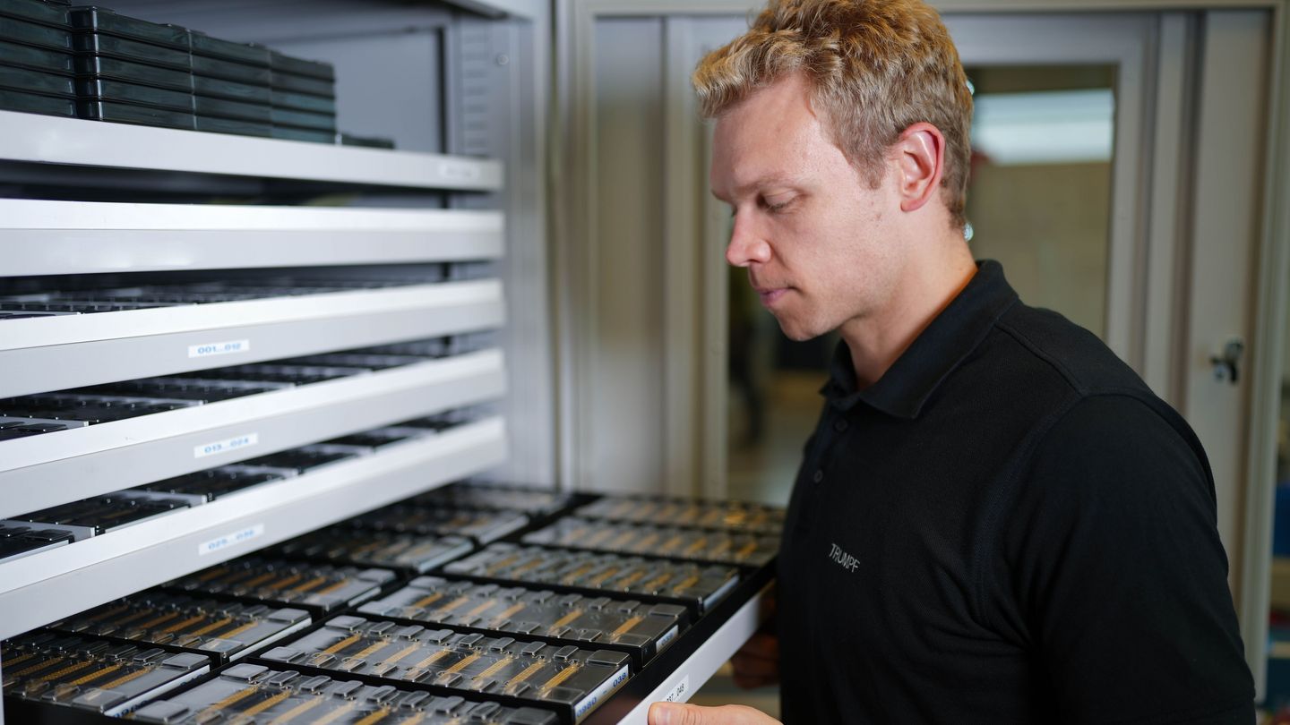

TRUMPF manufacturers in Germany
TRUMPF designs and manufactures its VCSEL-based systems in Germany. The TruHeat VCSEL systems are based on single VCSEL emitters.
