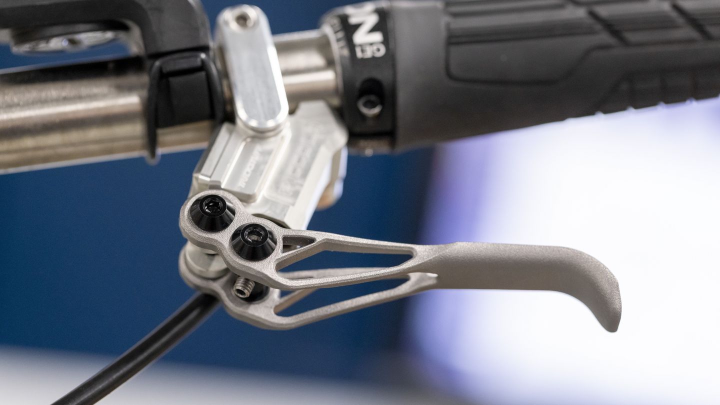

With 3D printers from TRUMPF, the bicycle industry can produce brake levers, for example.
Manufacturing brake levers with TruPrint 1000
The TruPrint 1000 3D printer from TRUMPF is suitable for manufacturing bicycle components such as brake levers.
Brake lever made of titanium
With 3D printers from TRUMPF, users can process different materials, such as titanium.
