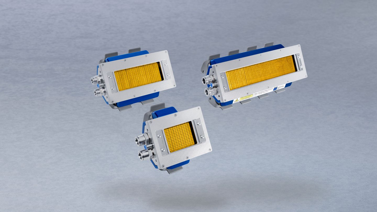

TRUMPF designs and manufactures its VCSEL-based systems in Germany. The TruHeat VCSEL systems are based on single VCSEL emitters.
TruHeat VCSEL systems for laser heat treatment
TruHeat VCSEL systems generate homogenous and direct infrared light, not only for brake pad scorching but also, for example, for the softening of high strength steels.
