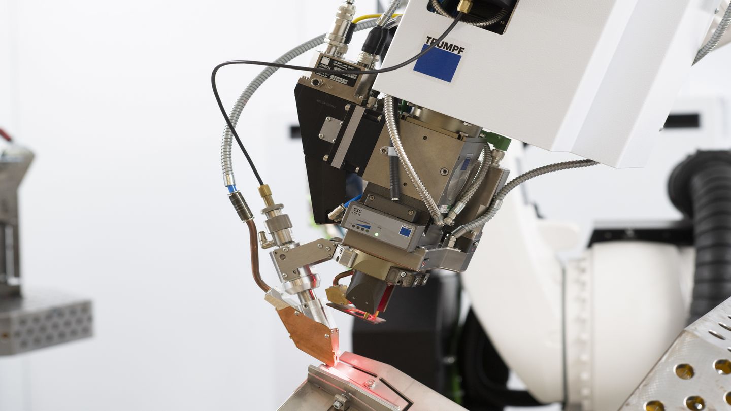

BrightLine Scan
TRUMPF's new BrightLine Scan technology enables the laser beam to be guided by the robot and laser scanner simultaneously. (Source: TRUMPF)
