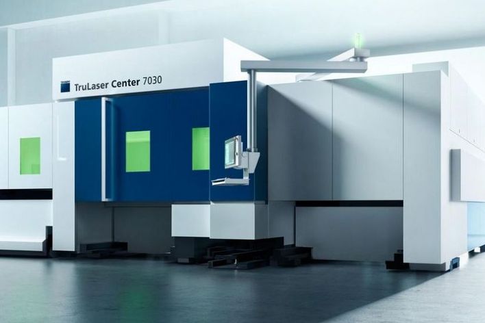

Virtual simulations of entire factories by computer: this is what engineers Carina Mieth and Tim Gottschalk from TRUMPF are working on.
