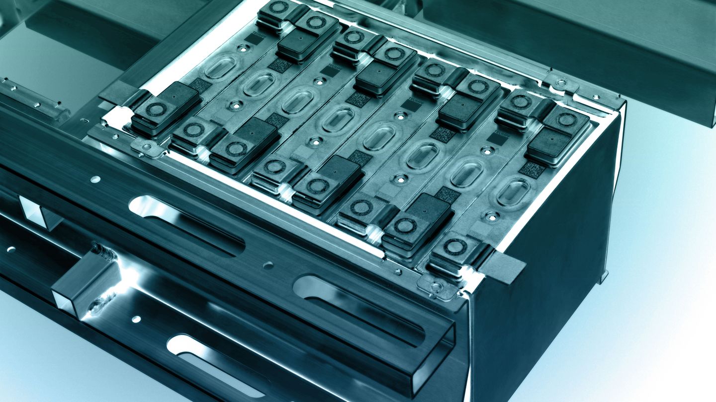

In future, manufacturers of electric car batteries could use compact X-ray sources to X-ray the batteries (symbolic image).
