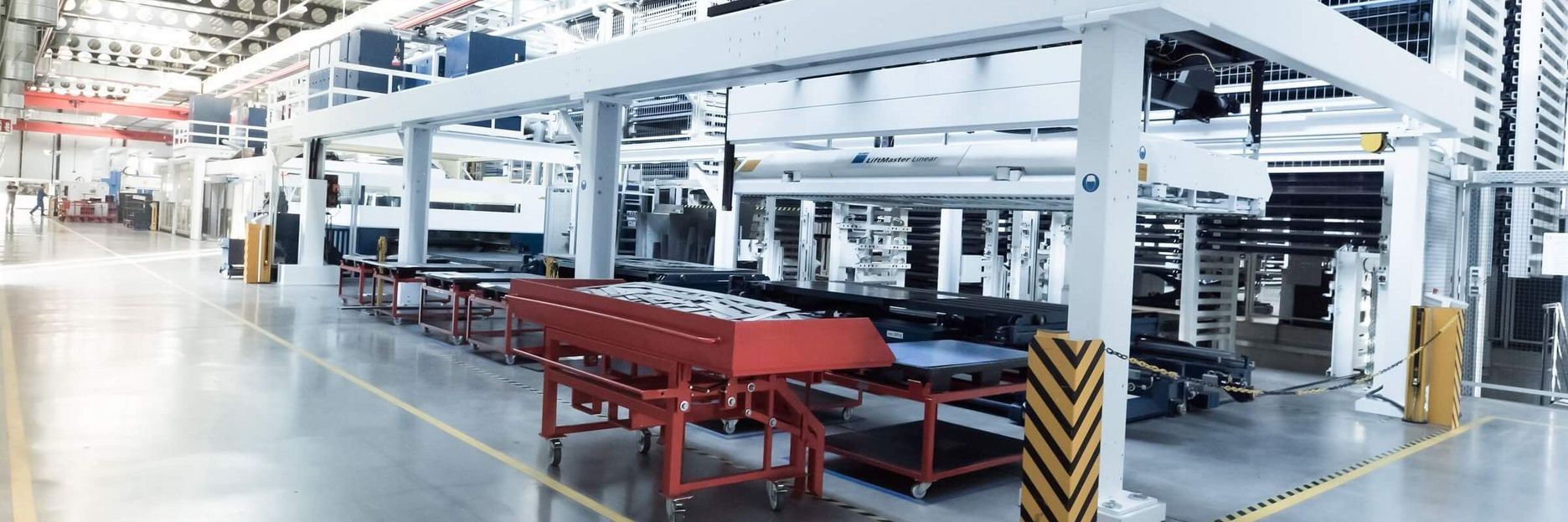

The fully automated Stopa storage system at KNOLL is 70 meters long. It also boasts more than 1,200 storage spaces and 13 loading/unloading stations. Riebsamen explains: “We knew we would have to store standard sizes, but we also needed to be able to store sheets measuring two by four meters. That’s why TRUMPF and KNOLL jointly designed a multipurpose storage system.” And then there is the automated storage and retrieval system (ASRS), which, along with the material supply system, is situated approximately one meter below the floor that supports the machinery. The advantage of this is that it’s easy to put materials into storage. Besides, Riebsamen adds with a wink: “We actually saved some money, too, as the soil conditions required the construction crew to dig deep no matter what!”
“We estimate that we’ve boosted our productivity in sheet metal processing during the past four years by at least 20 to 25 percent, probably more. And we’ll keep up the great work!”, says Joachim Riebsamen, manager of the Unfinished Structures Department at KNOLL. Picture: Stephen Duscher
The fully automated Stopa storage system at KNOLL is 70 meters long. It also boasts more than 1,200 storage spaces and 13 loading/unloading stations. Picture: Stephen Duscher
KNOLL has to store standard sizes, but also needed to be able to store sheets measuring two by four meters. That’s why TRUMPF and KNOLL jointly designed a multipurpose storage system. Picture:  Stephen Duscher
The ASRS is the centerpiece of any modern warehouse. It zooms vertically and horizontally from one storage space to the next, retrieving the appropriate unprocessed material and transporting it just in time to the right processing machine. Afterwards, the ASRS stores finished parts, or supplies items to other machines for additional processing. Equipment designers prioritize minimizing machine queue times and keeping travel paths as short as possible. In other words, the ASRS should move no more than necessary within the overall warehouse system. As Riebsamen knows, this is a complex challenge that demands a lot of expertise and experience – not to mention a lot of conversations about the specifics of a given customer’s manufacturing environment. “We realized during the planning/design phase that we would require a lot of loading/unloading stations. We wanted to connect three laser cutting machines, a TruLaser Fiber 3030, a water-jet unit and several bending machines. TRUMPF proceeded to spell out the types and numbers of loading/unloading stations we would need and where.” The TruLaser Fiber 3030, for example, is fitted with three stations. One supplies the machine with unprocessed material. A second station takes away finished parts, while a third station serves exclusively to dispose of scrap skeletons. Only three TRUMPF customers have instituted this solution thus far. Joachim Riebsamen thinks it’s great: “Scrap skeletons are transported back to the warehouse. Within the system, they are stacked onto pallets and removed from the plant via the material supply system. Our production workforce no longer needs forklift trucks to dispose of scrap.”
