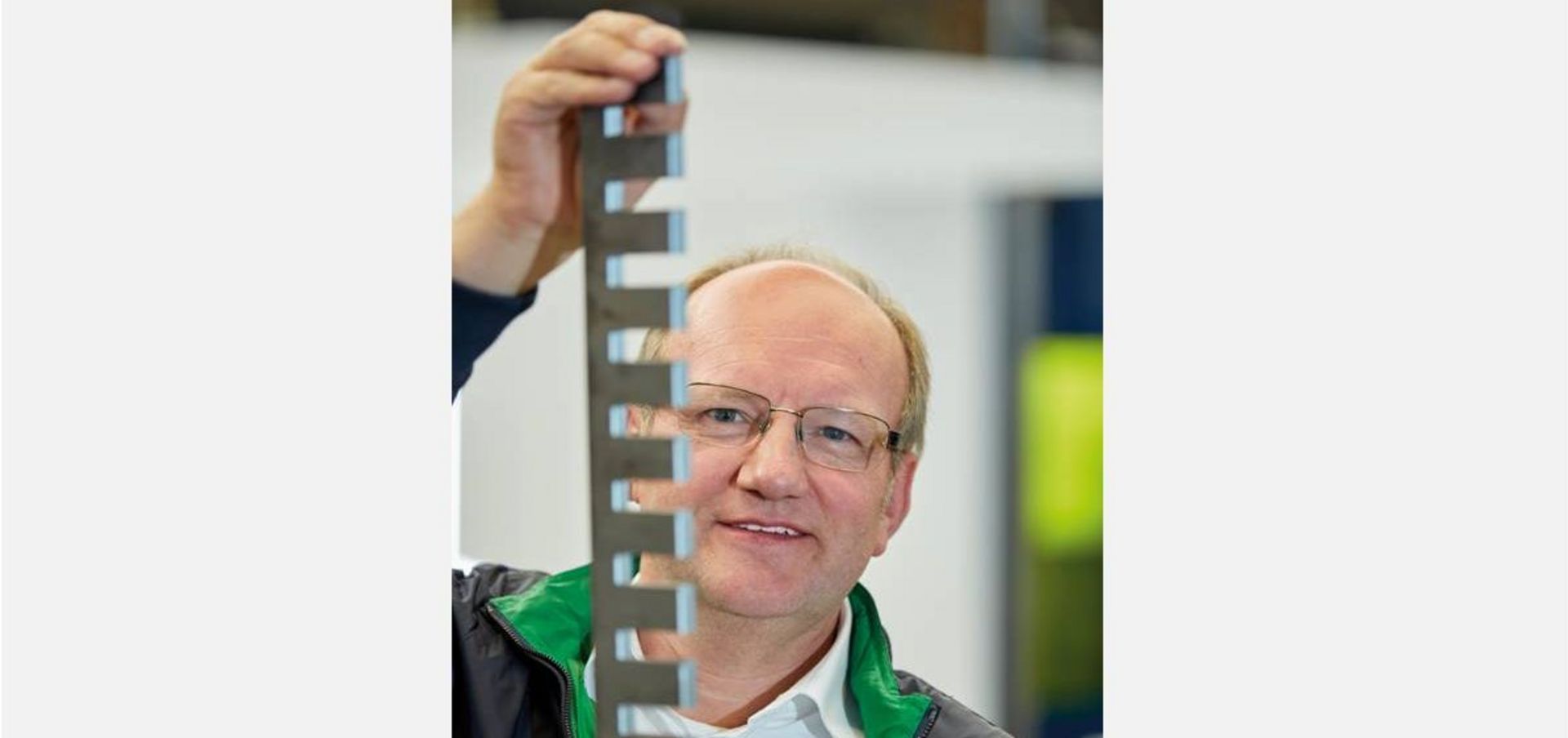

In its automated manufacturing operations, a Stopa storage system with 1,450 positions provides materials as needed during the two shift s and — if necessary — during lights-out operations at night and over the weekend. That is why process reliability has a high priority for Hermann Schickling. But that is only one advantage with which the 8-kilowatt laser racks up points. “In the past we had to farm out many orders for cutting thick sheet metal. That is now a thing of the past. With the TruDisk 8001 and the BrightLine fiber function we have not only achieved superior cutting results for 25 millimeter mild steel and stainless steel up to 40 millimeters, but also profit from the high quality of the edges,” Schickling explains.
A Stopa storage system takes care of supplying materials while a LiftMaster makes it easier to handle parts. (Picture: Claus Langer)
The BrightLine fiber option produces amazing cut edges at impressive speed, when working with mild steel 25 millimeters thick. (Picture: Claus Langer)
The machine was set up and has run absolutely smoothly since the very first moment. “You can’t get any better than this,” say Hermann Schickling. (Picture: Claus Langer)
