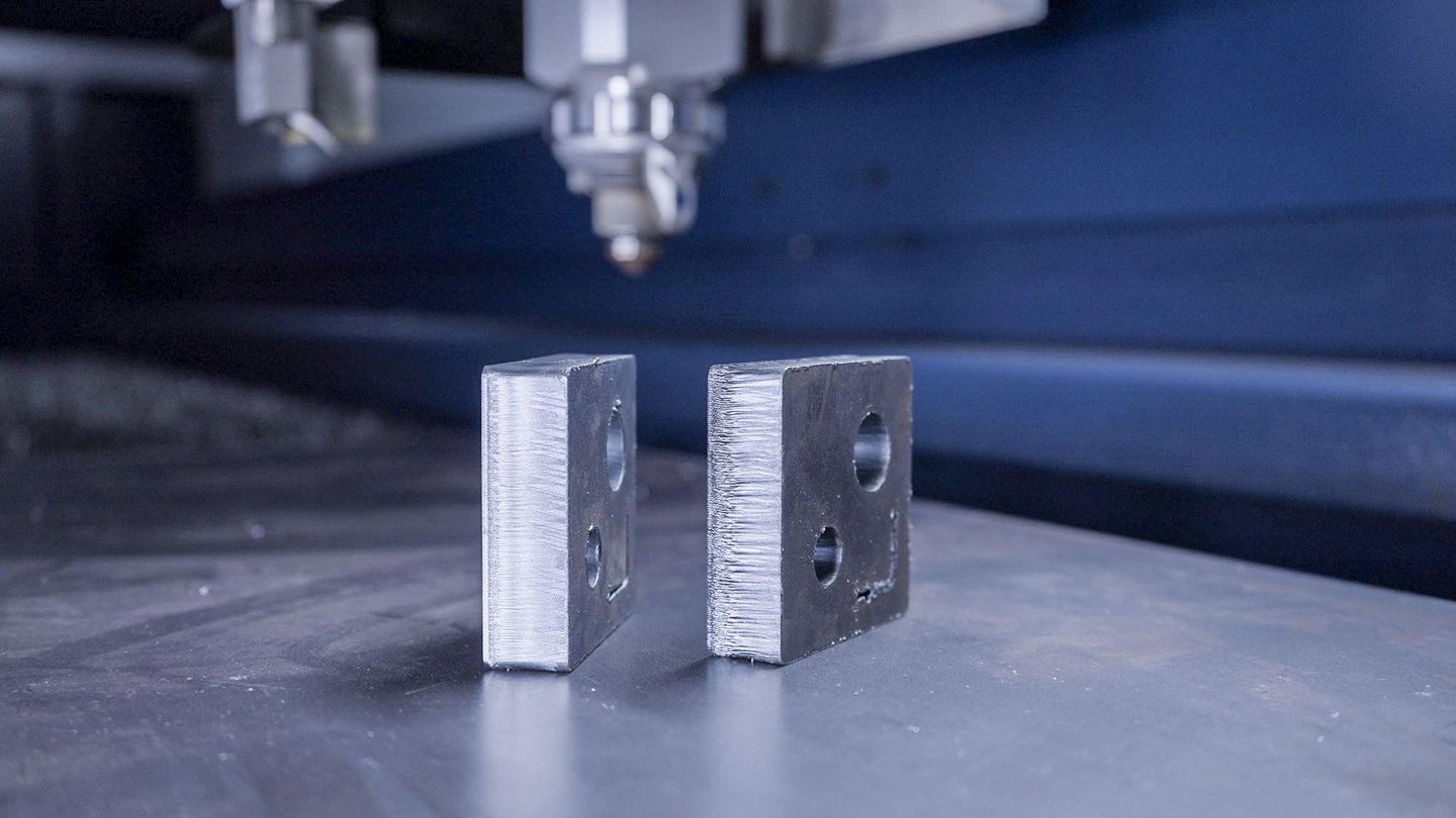

Perfect cut edges
With the Cutting Assistant, users get the perfect laser cutting parameters for their material. All they need to do is take a photo of the cut edge using a hand scanner. The AI takes care of the rest. (Source: TRUMPF)
No specialized knowledge required
After about five runs, the solution enables perfectly cut component edges– with no experience or programming. (Source: TRUMPF)
