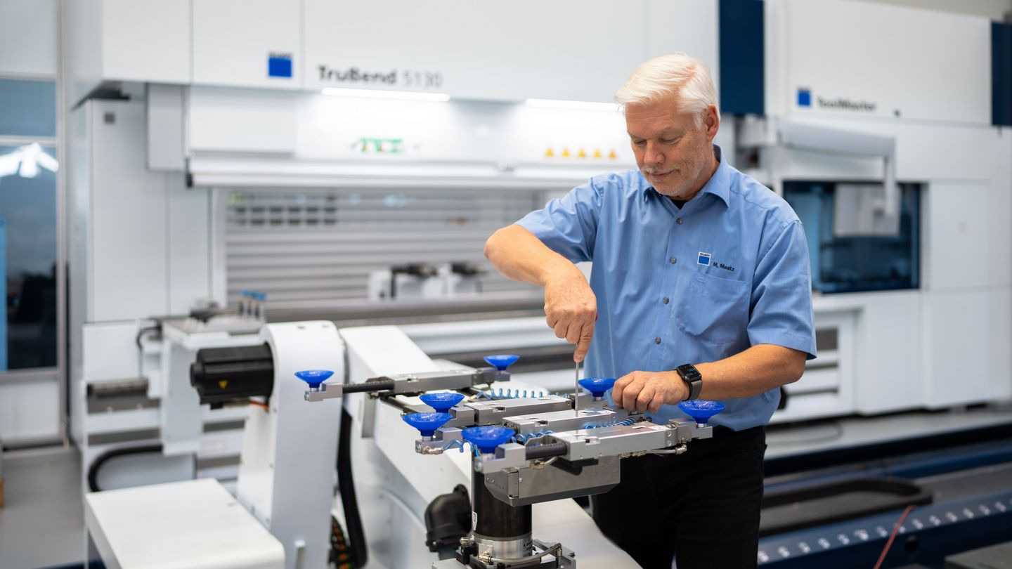

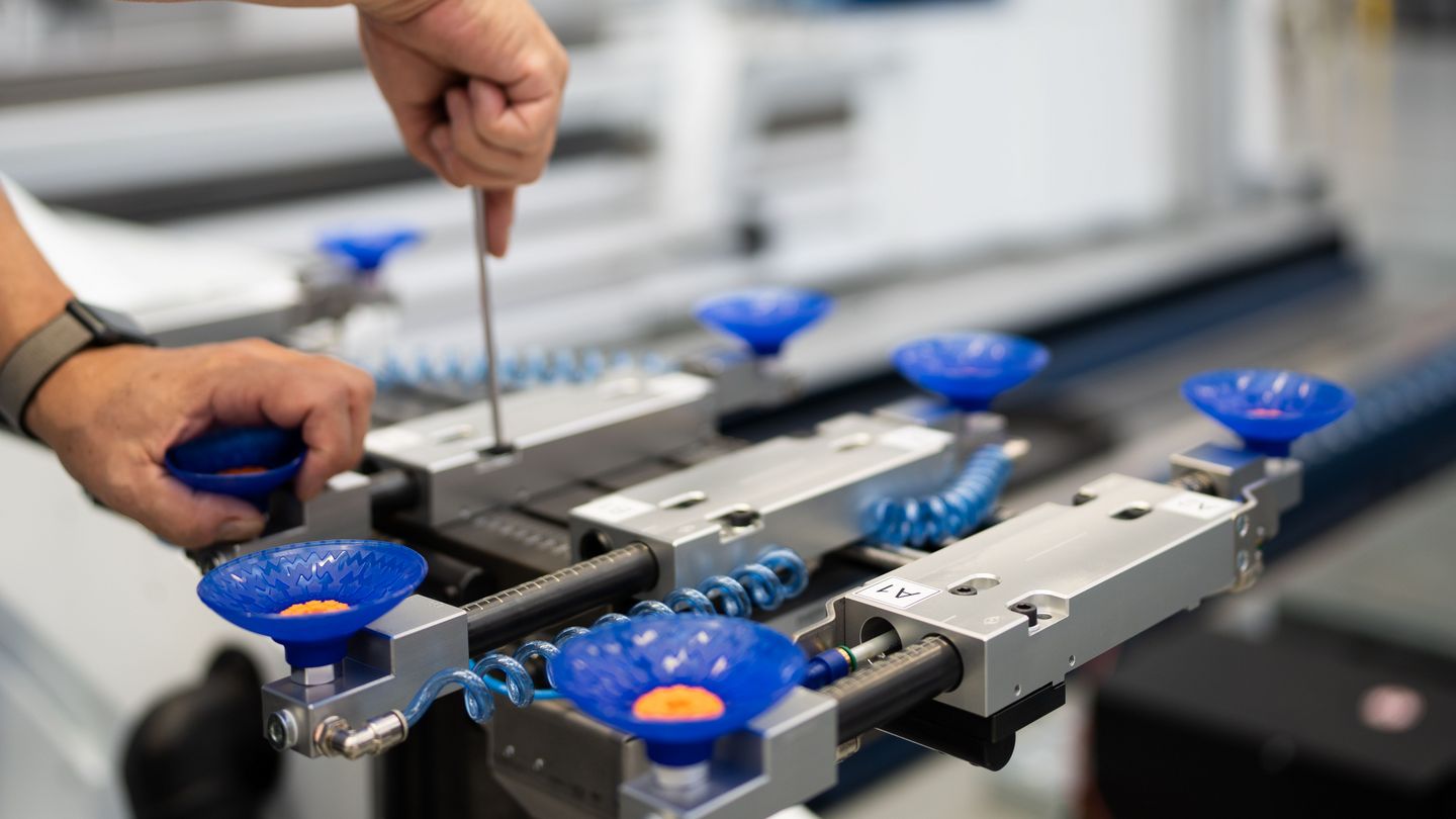

Multigripper
TRUMPF's new multigripper handles components in the bending cell faster and more flexibly than conventional grippers. (Source: TRUMPF)
Fast setup
The new multigripper can be set up particularly quickly, as changes can be made directly on the system (Source: TRUMPF)
