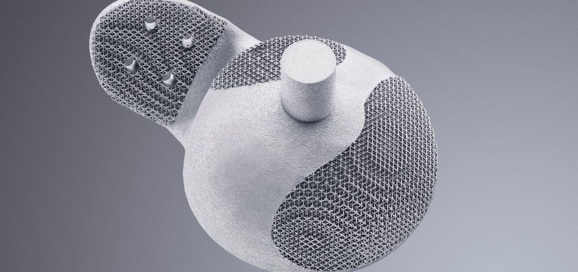

Medicine: Individual implants are available quickly and have a better biological functional integration, for example, using structures which promote ingrowth into the tissue.

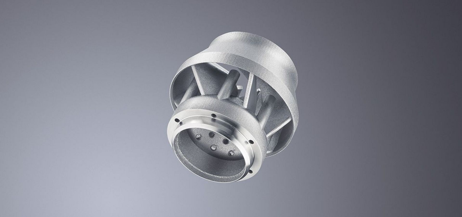

Prototype: The impeller component is a prototype from the Powertrain Development Department. This component geometry was tested by Volkswagen AG to optimize flow behavior within the motor.
