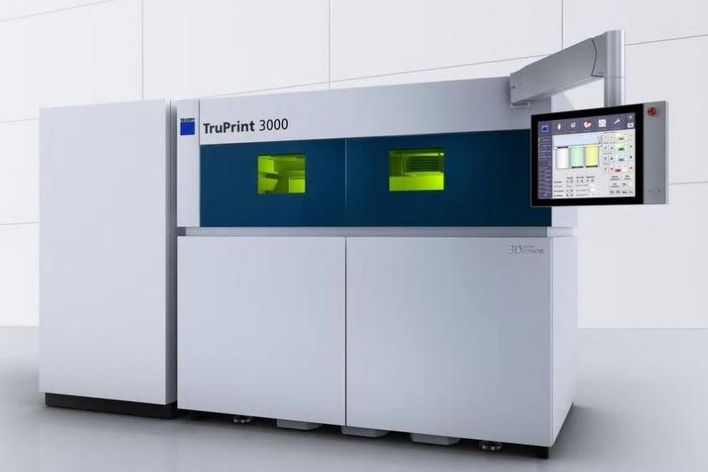

CES has also been printing metal parts since January 2018, using two models from the TruPrint 3000 range of 3D printers from TRUMPF. CES has long relied on this Ditzingen-based high-tech company as a trusted partner. It currently has a total of ten TRUMPF systems that it uses to cut, weld and bend sheet metal. Based on the positive experience CES has had with TRUMPF in the past, they opted to take the same route for metal 3D printing.

In January 2018, CES began printing parts for the automotive industry on two machines from TRUMPF’s TruPrint 3000 series.

Kammann relies on his two TruPrint machines to print parts that require high quality surfaces. “Only 3D printing can produce a surface as beautifully smooth as this,” Kammann says, running his hand over a gleaming accelerator pedal. “This kind of result makes an outstanding impression on customers that produce luxury vehicles,” he adds. He also uses the TruPrint 3000 to 3D print mirror housings, displays and control units. CES even uses the TRUMPF machines to print parts for its in-house production needs. Kammann recalls how the team was unhappy with the shielding gas nozzle for the robot welding cell. The cooling channels, drilled apertures and fluid flows simply didn’t meet their requirements, so the engineers decided to design and print a new part that would have been impossible to make by conventional means. The new part distributes the shielding gas more evenly throughout the welding cell.
Printed brake calipers brake better
Kammann is particularly proud of a brake caliper he produces for a number of automakers on the TruPrint 3000. It is still fairly unusual to see 3D printing being used for these kinds of production-scale components, largely because suppliers are required to obtain a road permit, which is a complex and costly business. They have to perform numerous tests to demonstrate that the printed part behaves exactly the same on the road as a part made using conventional methods. “Few companies can do that, because it requires in-depth knowledge of the processes and quality requirements,” says Kammann. In the case of the brake caliper, the ADaM team carried out computed tomography scans and tensile tests as well as dynamic load tests, which involved applying high pressure to the brakes some 30,000 times. The results showed that the printed brake caliper was actually more resilient than the brake caliper produced by conventional means. “That was enough to persuade our customer to use AM methods to produce the brake caliper in the future,” says Kammann. Even better, the 3D-printed brake caliper turned out to be quicker to produce. The delivery time for traditional sand casting methods is around 12 to 14 weeks, but that drops to just one week with 3D printing. Conventional manufacturing methods may be cheaper for bigger orders, but 3D printing is an excellent choice for producing brake calipers in small batches.
