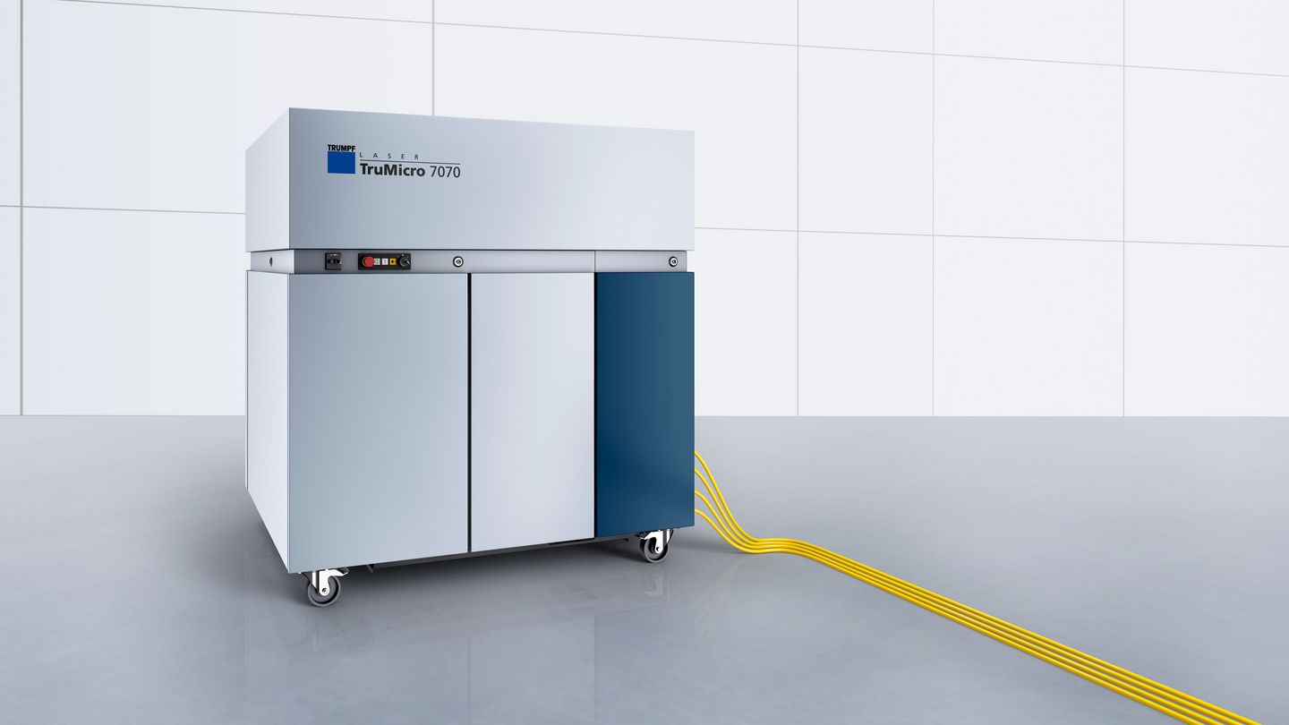

TruMicro 7070 with multiple beam outputs
The "Large" version of the TruMicro 7070 now offers up to four output ports. The laser power can be distributed across all four ports simultaneously or transmitted in its entirety through a single port. (Source: TRUMPF)
