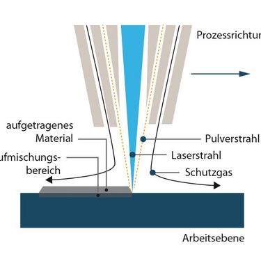

How LMD works
A nozzle applies fine metallic powder to a component. A laser beam is directed through the middle of the nozzle, producing a melt pool on the surface of the component into which the powder particles are incorporated. The nozzle is mounted on an optics system which is moved by a robot or Cartesian machine at a distance of between six and 16 millimeters from the workpiece.
