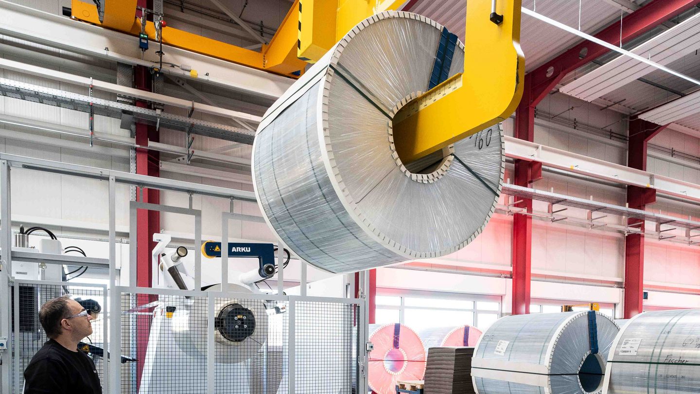

Coil production enables users to achieve more efficient nesting of parts. Conventional sheets are limited by their four outer edges, which often make it difficult for production workers to make full use of the entire sheet. Unused sections of the sheet either have to be discarded as scrap or melted down. A coil, which can be up to 1.5 kilometers long, solves this problem by allowing users to nest an almost endless number of parts on the sheet. This reduces material consumption by around 15 percent. Compared to conventional blanking presses, the new system also heralds a significant reduction in construction and logistics costs. It makes production more profitable by eliminating tooling costs, optimizing the use of material, reducing assembly costs and boosting flexibility in the production environment.

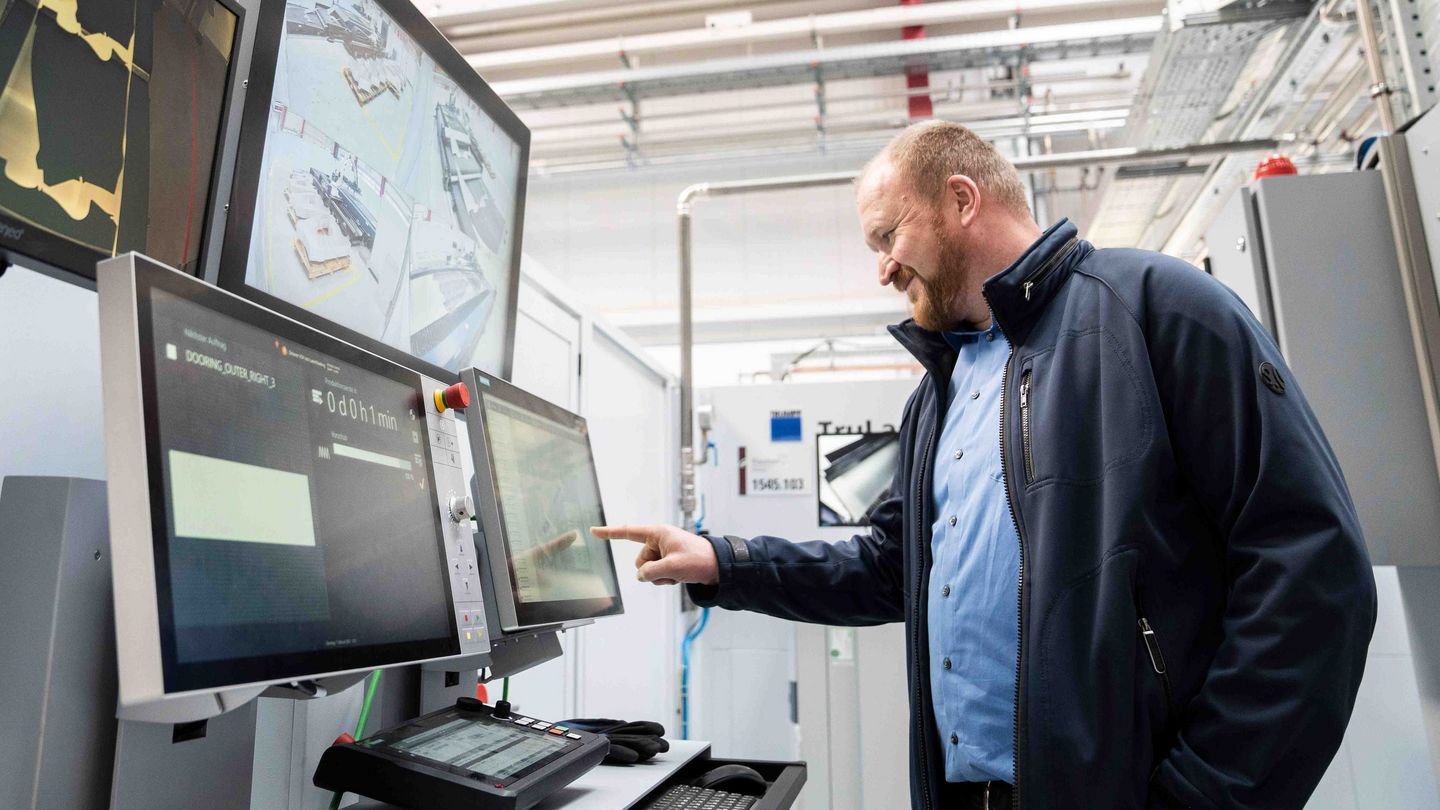

The production system is fully automated. An innovative system for transporting the sheet metal during cutting keeps the material moving quickly through the whole process, with impressive gains in productivity. The new system also uses many of the tried-and-tested features that TRUMPF is renowned for. These include Smart Collision Prevention, which prevents cut parts from tilting and damaging the laser cutting head. The entire line – from the coil stock to the pallets of finished parts – can be conveniently monitored and controlled from a single operator module. The points at which parts are removed and stored are automatically programmed and displayed on the screen, for example, and the portable operator module can be used at any of the key points in the system for set-up and servicing tasks.

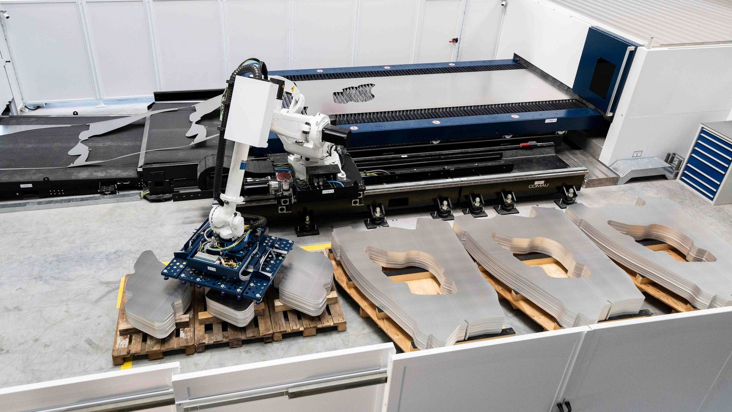

A robot is used to unload the entire system to ensure fast and reliable part removal. TRUMPF’s TruTops software, which will be merged into Oseon in the future, calculates the input data for ready-made cycles or part programs that run on the Sinumerik. This means users do not have to worry about the specific robot movements or how these are programmed, so the robot can be handled without any specialist expertise or prior training.

“The Sinumerik One lies at the heart of efforts to globally transform the machine-tool industry and to future-proof manufacturing in an increasingly digitalized sector. Thanks to the seamless interaction between the virtual and real portfolios, the Sinumerik One enables machine makers such as TRUMPF to significantly reduce time to market while offering users the benefits of improved machine performance,” says Uwe Ruttkamp, head of Machine Tool Systems at SIEMENS. The loading module was developed by ARKU, a global market and innovation leader for roller levelers. It can accommodate coils up to 2,150 millimeters wide and accepts a variety of materials. The system is already available for purchase.
