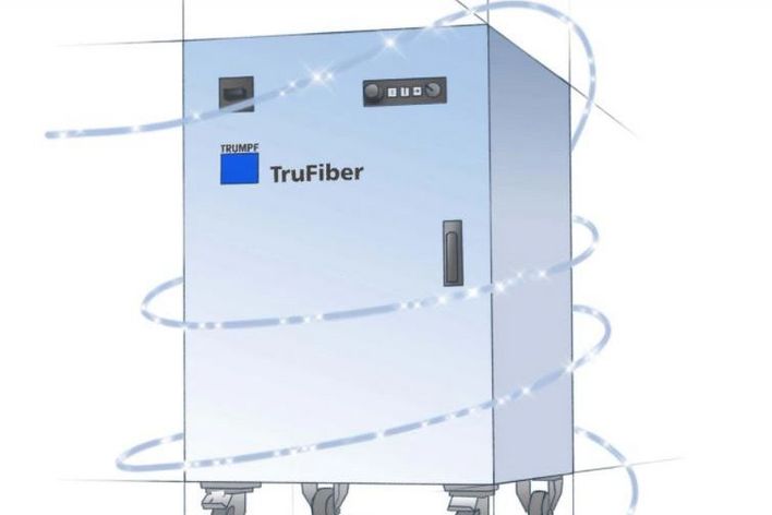

The most important criterion for the welded parts: the seal. Mühleck explains: "No moisture may penetrate the endoscope. Our reusable products are used several times. During steam sterilization after a medical procedure, the endoscopes are exposed to high temperatures and pressures. They have to withstand these." The demands on the weld seam were correspondingly high. The stainless-steel parts are less than one millimeter thick, and the welding depth and weld width are therefore small. The Karl Storz project team chose a fiber-based TruFiber 500 solid-state laser from TRUMPF with 500 watts of power as the laser source. This is precise enough to reliably weld the filigree parts. In addition to quality and speed, efficiency also played an important role for Wolfgang Karl in choosing the laser. "With the new laser, we have reduced our production time per component from ten to one and a half seconds. So we are significantly faster. We also consume much less energy," says Karl.
