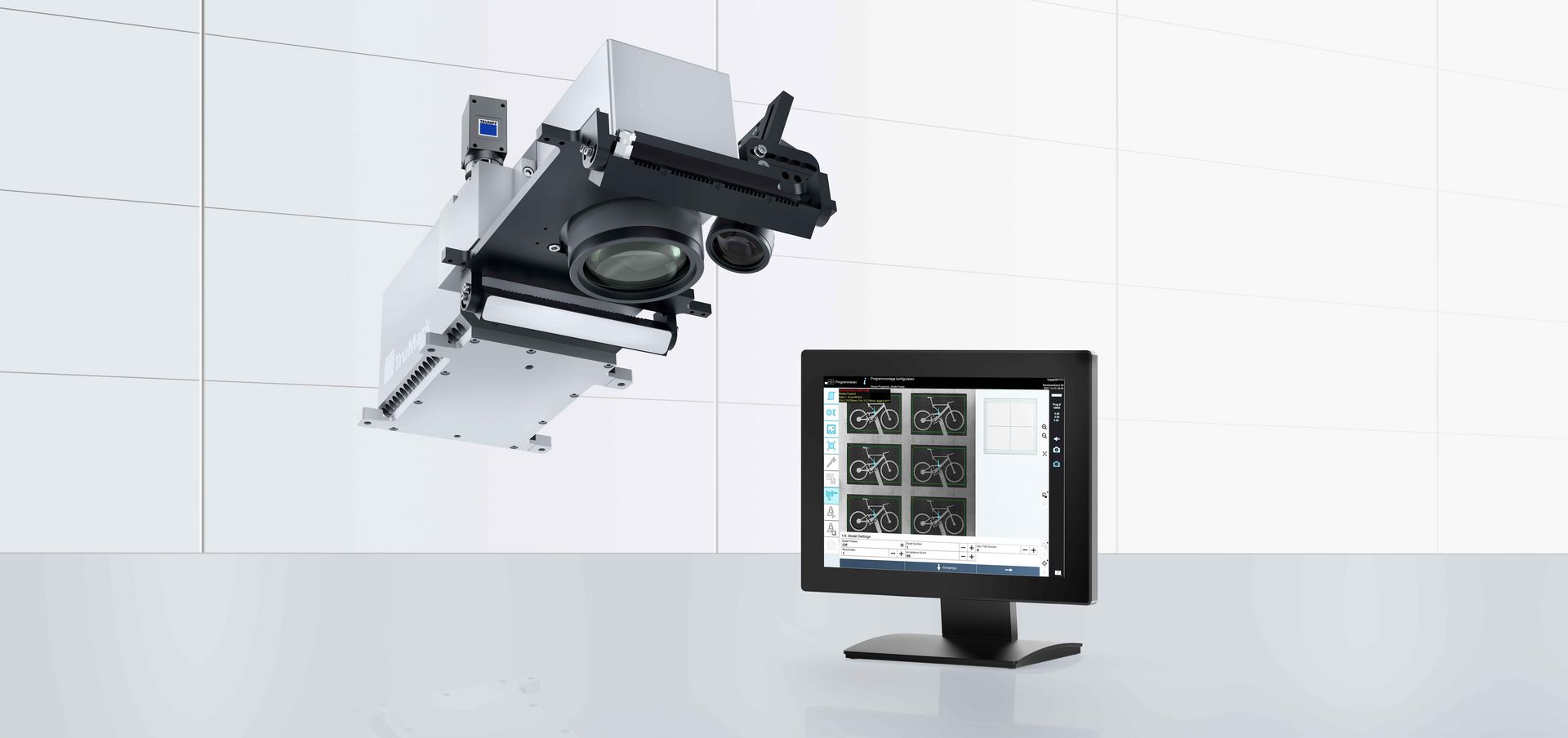

4. Component and position recognition
The image processing programs VisionLine Detect or VisionLine Model detect the component and its exact location and position. The software forwards the information to the controller which makes the marking in the precise position.

Using the image processing programs VisionLine OCT (for character recognition) or VisionLine Code (for 1D/2D codes), marked data can be compared against the database and stored for documentation purposes with additional information if desired.   This includes information on UDI code content and quality, or on the machines involved in the process. This ensures proper documentation of the component and marking even after many years.

Image processing for marking applications
Get support in every phase of the entire UDI process and increase your process reliability – thanks to VisionLine image processing. It detects the position of the component, for example, and ensures that marking is performed in the correct location.
