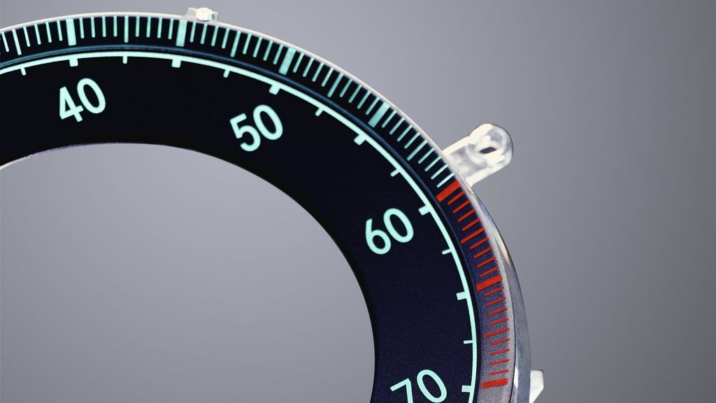

Types of laser marking for plastics

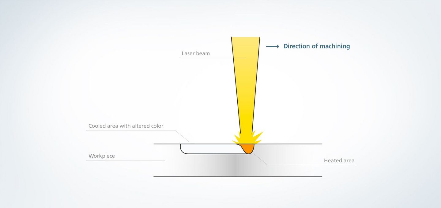

Color change: process diagram
TRUMPF laser marking annealing application
The laser dose alters selected molecules and thus brings about a change in color.

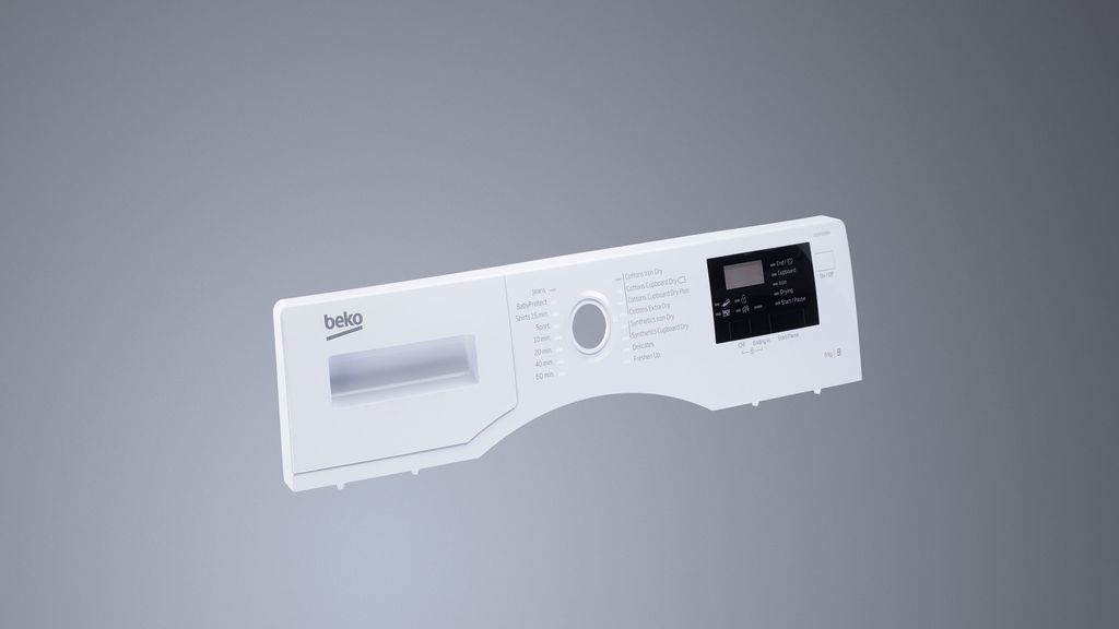

How can flame-retardant or flame-resistant plastics be laser marked?
TRUMPF marking laser application in flame-retardant plastics
Especially when processing flame-retardant plastics, it is important that the material and wavelength are optimally matched to each other. Here, the use of a UV laser is recommended. Dark gray markings can then be made on light materials. Discoloration is caused by the break-up of chemical compounds. As the material does not burn or carbonize, it is referred to as "cold marking" with high surface qualities.

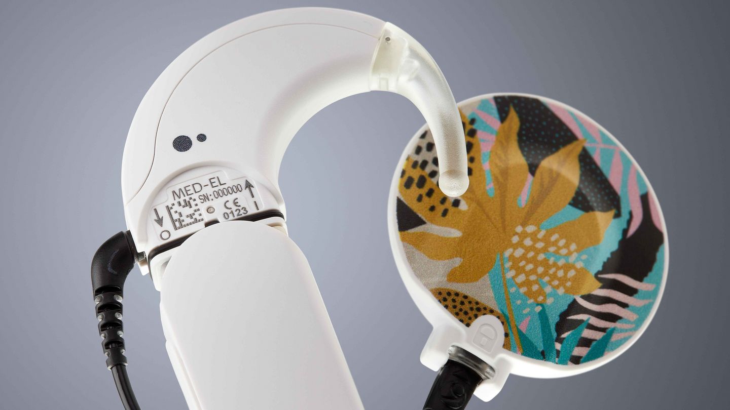

Laser-marked speech processor
Speech processor
Speech processor with antenna (MED-EL Elektromedizin Geräte Gesellschaft m.b.H.) laser marked with the TruMark Series 3000:

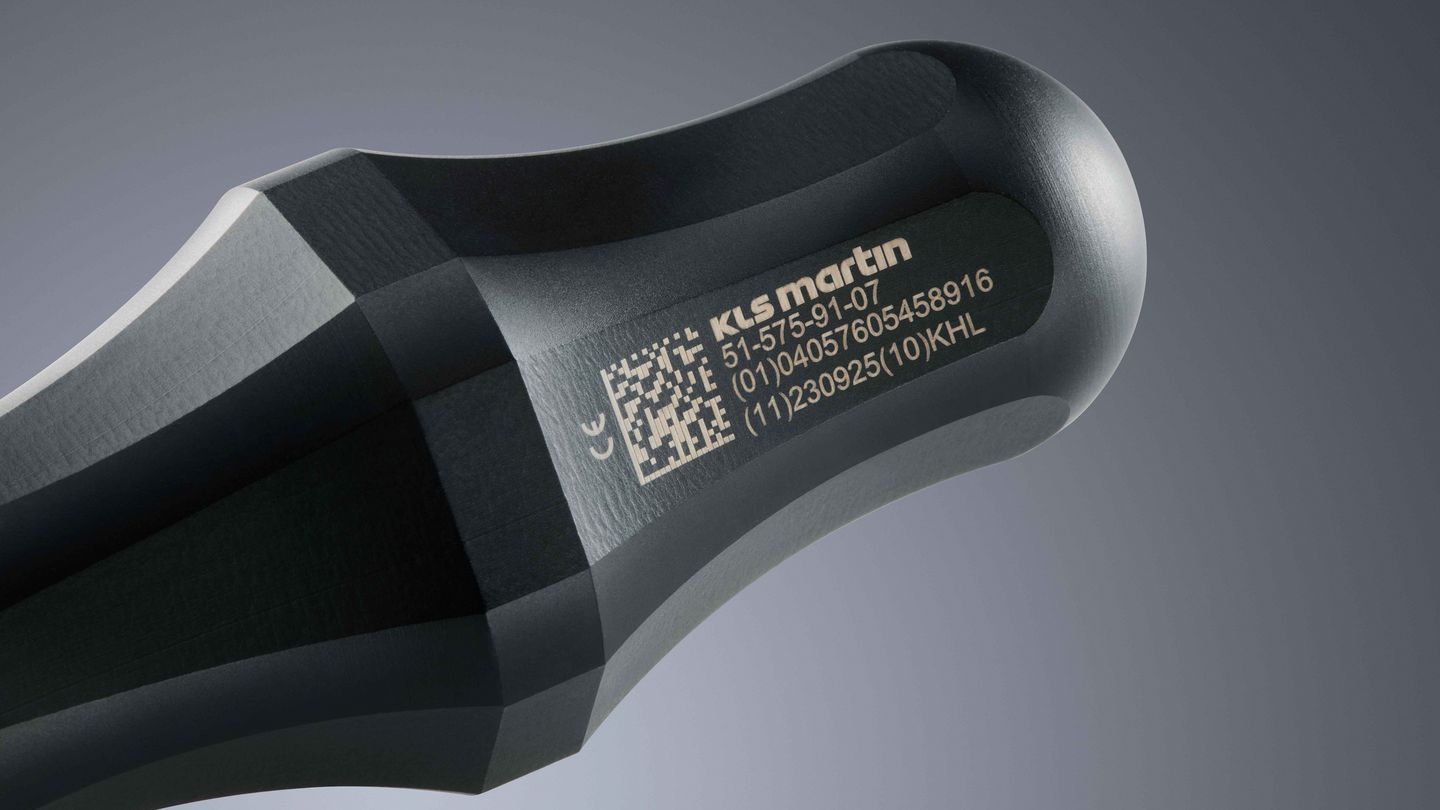

Laser-marked screwdriver handle
Screwdriver handle
Plastic screwdriver handle (KLS Martin) marked with the ultra-short pulse laser TruMicro Mark 2030:

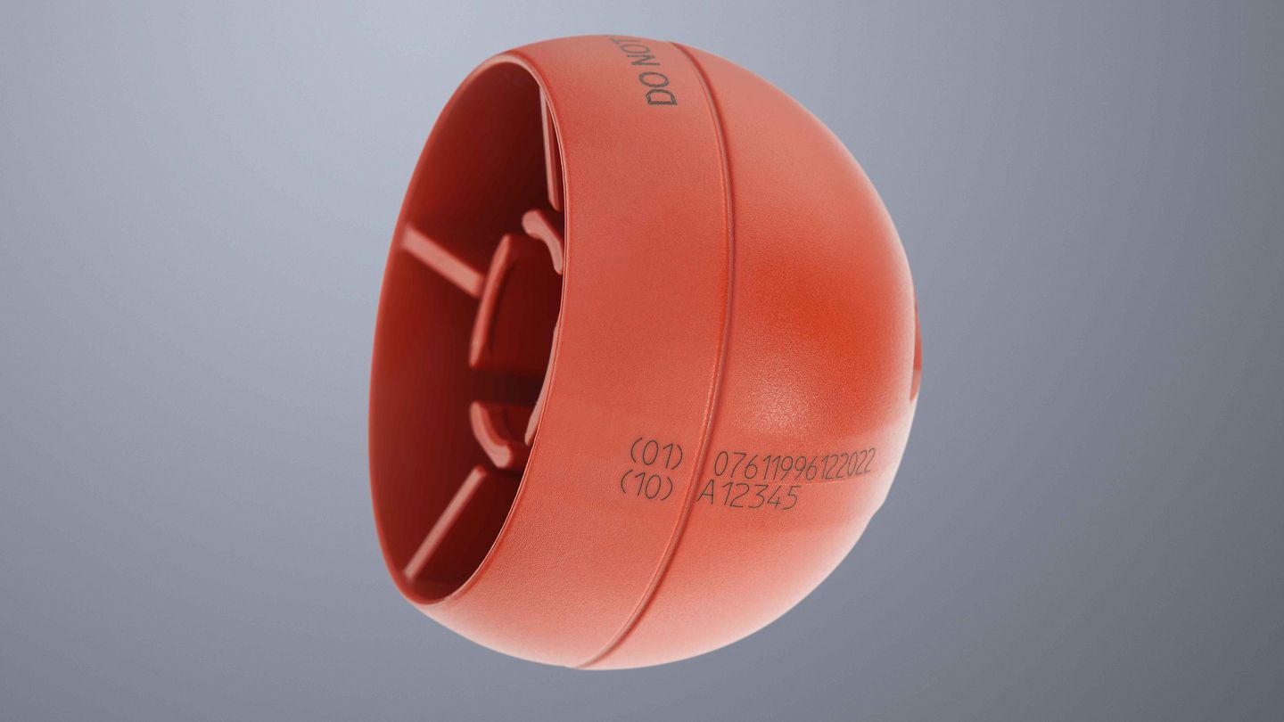

Laser-marked test ball joint of a hip implant
Test ball joint for hip implant
3D plastic marking of a test ball joint (SAMAPLAST AG) for a hip implant with the TruMark 6030

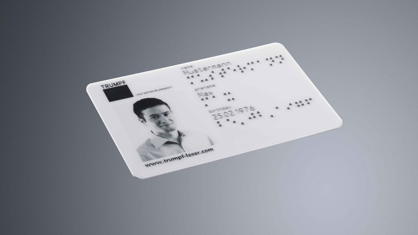

TRUMPF laser marking on plastic ID card
ID labeling
Color changing and foaming enable the flexible creation of highly legible, durable, and high-contrast labels and images, e.g. ID cards.

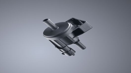

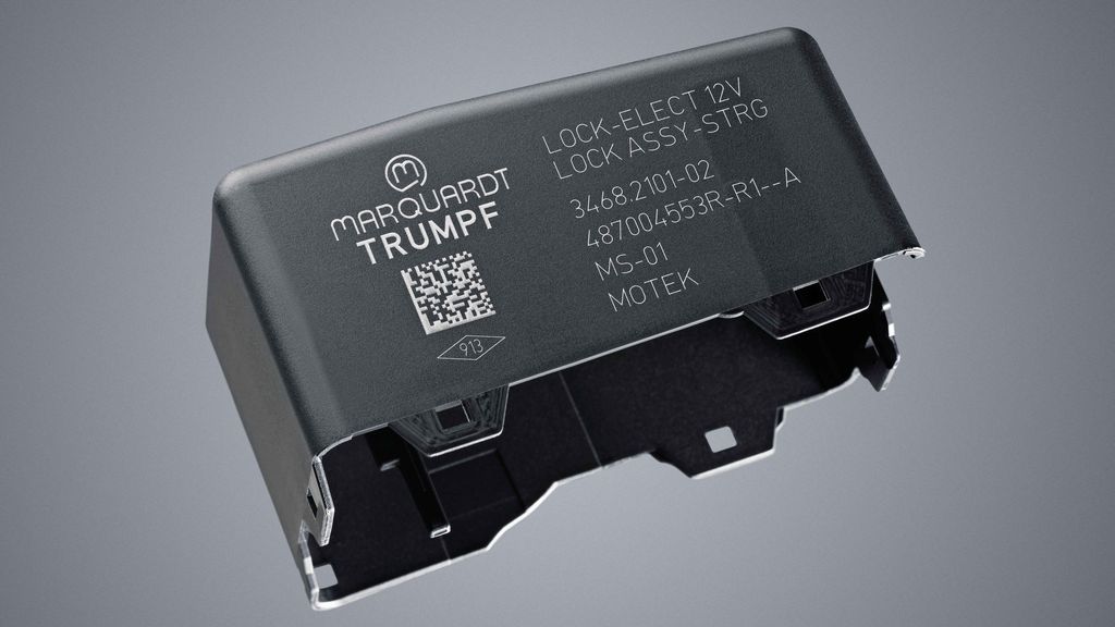

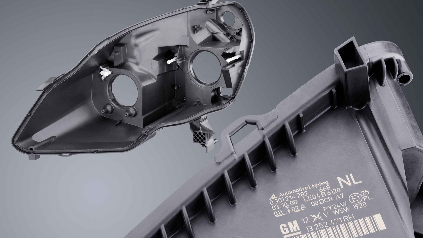

TRUMPF laser marking on plastic automotive components
Product identification
The flexible laser tool applies high-contrast and permanently legible, high-resolution product markings even in difficult to access areas.

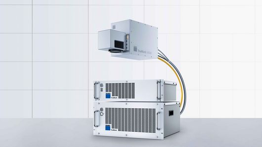

TruMark 6030 marking laser
TruMark 6030
With the TruMark 6030 marking laser, you can make the most of the advantages offered by the next generation of marking lasers by TRUMPF. The laser's high level of performance and excellent beam quality guarantee that you will achieve brilliant laser markings for applications in all industries.
