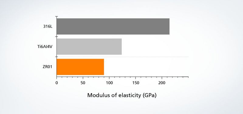

Elasticity module
Amorphous metals have a low elasticity module (E-module 87 GPa for Amloy-ZR01 and 89 GPa for Amloy-ZR02). As this is very comparable with human bones, the alloys are suitable for medical applications.

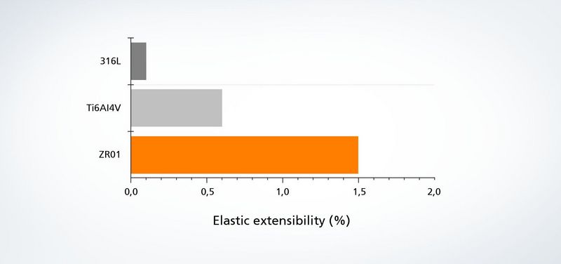

Elastic flexibility
The very high elastic flexibility (> 1.5 %) of amorphous metals ensures that components absorb a lot of energy in the elastic range, transmitting it again without deforming. This makes these alloys particularly suitable for applications under elastic stress.
