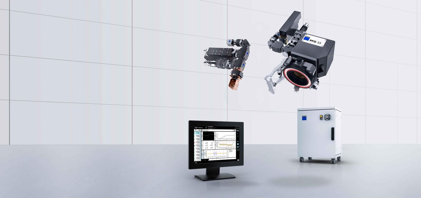

Sensor system
VisionLine OCT Check
Welding depth monitoring and seam geometry measurement
Process-synchronous quality control in welding
The VisionLine OCT Check process sensor system ensures reliable and precise welding depth monitoring. The use of optical coherence tomography (OCT) makes process-synchronous quality assurance possible, for example by measuring the keyhole depth in deep welding processes. The geometry of the solidified weld seam is measured by an additional OCT scan. Due to the optimal interaction of PFO and OCT, process-synchronous measurement of keyhole depth is possible in the entire work area of the PFO - with no parameter adjustment necessary.
Robust
The robust OCT design and clever integration into the optics system enable measurements even under fluctuating ambient conditions.
Fully integrated
For minimal interfaces and simple integration of systems
Easy operation
User-friendly software interface
Fast
Fast availability of results for and low cycle times
Transparent and traceable
Inspection of each component with 100% traceability of the welding depth along the entire weld seam
Including VisionLine OCT Detect
All VisionLine Detect and VisionLine OCT Detect features are already included.

PFO 33 Product Family
Fully integrated
VisionLine OCT Check is seamlessly integrated into the TRUMPF solutions portfolio. This ensures that the OCT functions can be optimally used in the entire PFO working area. Aside from the known fieldbus interfaces, no further interfaces are necessary. The OCT is also integrated in the safety circuit of the laser and is automatically controlled via TruControl.
Configuration
Available lasers TruDisk (1030 nm, 515 nm), TruFiber (1075 nm, Multi Mode)
Available optics PFO 33 1 2
Parameters
OCT wavelength spectrum (laser class) λ = 820 nm - 860 nm (Klasse 3B)
OCT sensor measurement rate 250 kHz
Axial measurement range ± 5 mm (je nach Brennweite)
Lateral measurement range Ø 15 mm - 25 mm (je nach Brennweite)
Axial resolution 12 μm
Lateral resolution ≥ 2 μm (abhänglig von Parametern und optischem Aufbau)
Typical measurement range - welding depth measurement 0.5 mm - 5 mm (je nach Prozessdesign und optischem Aufbau)

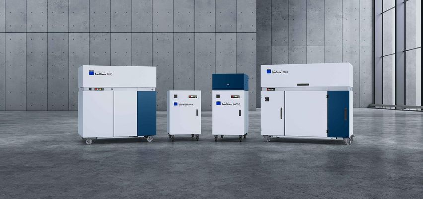

Image of the technology inside the TRUMPF disk laser
Lasers
Whether it's cutting, welding, marking, or processing surfaces: with TRUMPF, you benefit from the flexibility, versatility, and cost-efficiency provided by lasers.
