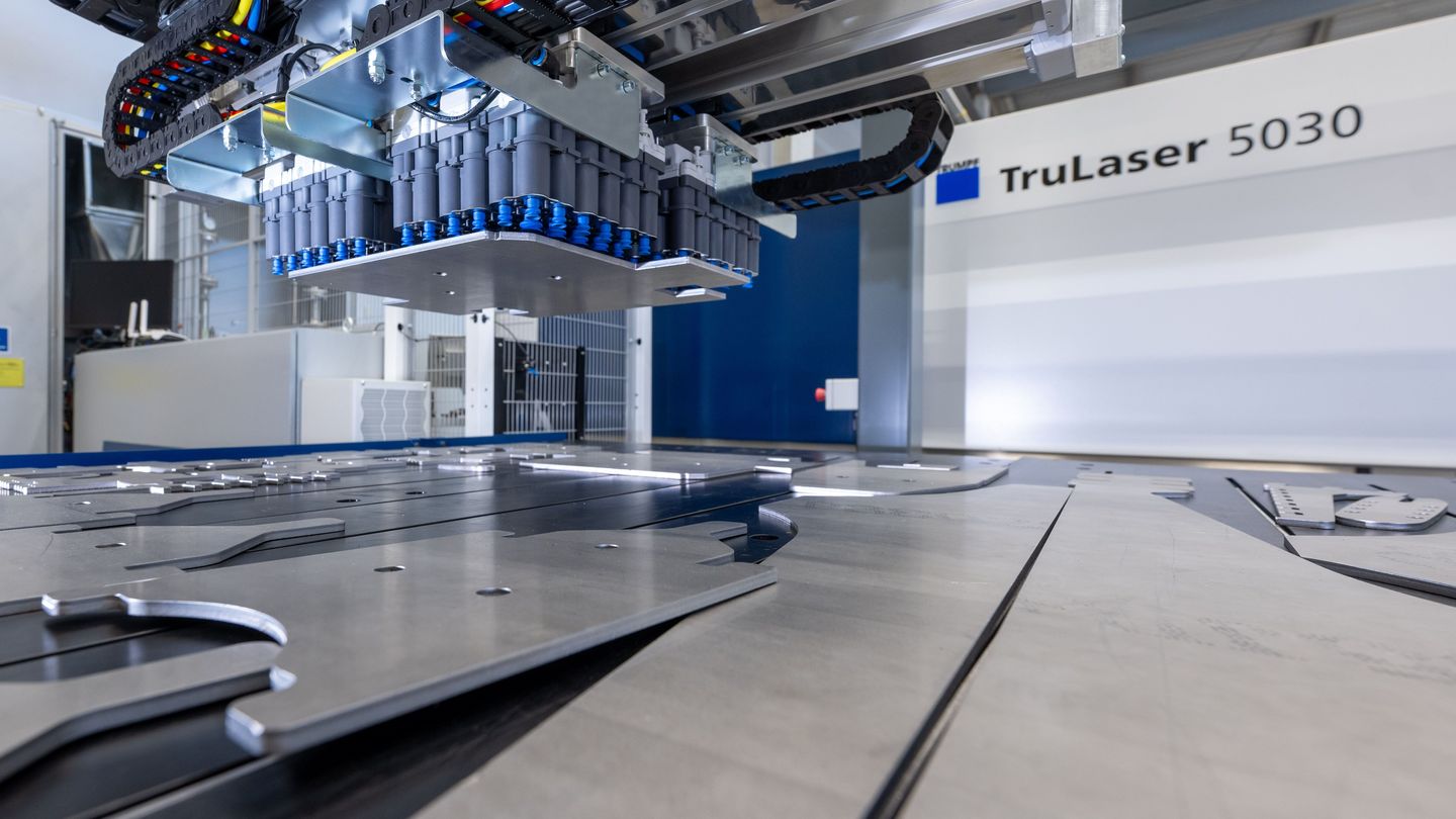

The solution uses a LiftMaster Compact loading and unloading automation system from TRUMPF. It removes the cut sheet from the pallet changer of the cutting machine and transfers it to the SortMaster Station. This separates the components from the scrap skeleton in just a few seconds. Separated parts are then conveyed to the sorting area.
“This solution decouples the cutting, separating and sorting processes from each other for the first time,” explains Bunz. “This allows users to better utilize their laser machine and increase throughput. A third pallet station enables parallel manual sorting, for example, of special formats, or handling of thick plates up to 2 inches.”

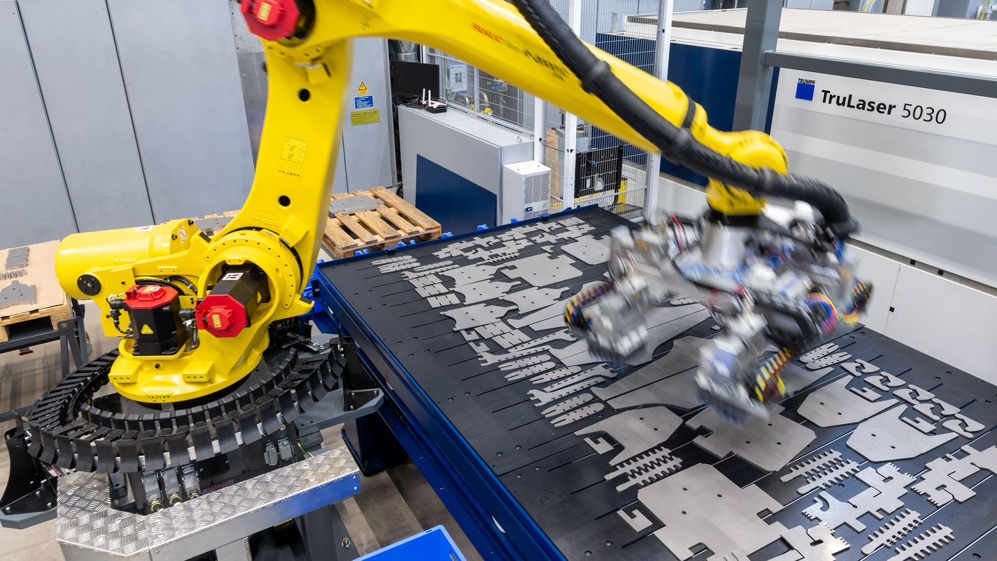

The SortMaster Vision is used for automated sorting. For several years, TRUMPF has worked with Intrinsic, a leading AI and robotics software company, to introduce adaptive robotics capabilities such as automated perception and robot path planning for the SortMaster Vision. This enables the robot to autonomously recognize separated parts using AI-supported image recognition. The software autonomously calculates the robot’s motion plan including the gripping points. The SortMaster Vision independently obtains all the part information from the cutting program, uses it to simulate various removals in advance, and selects the most suitable one at runtime. This eliminates the need for programming of the sorting process.

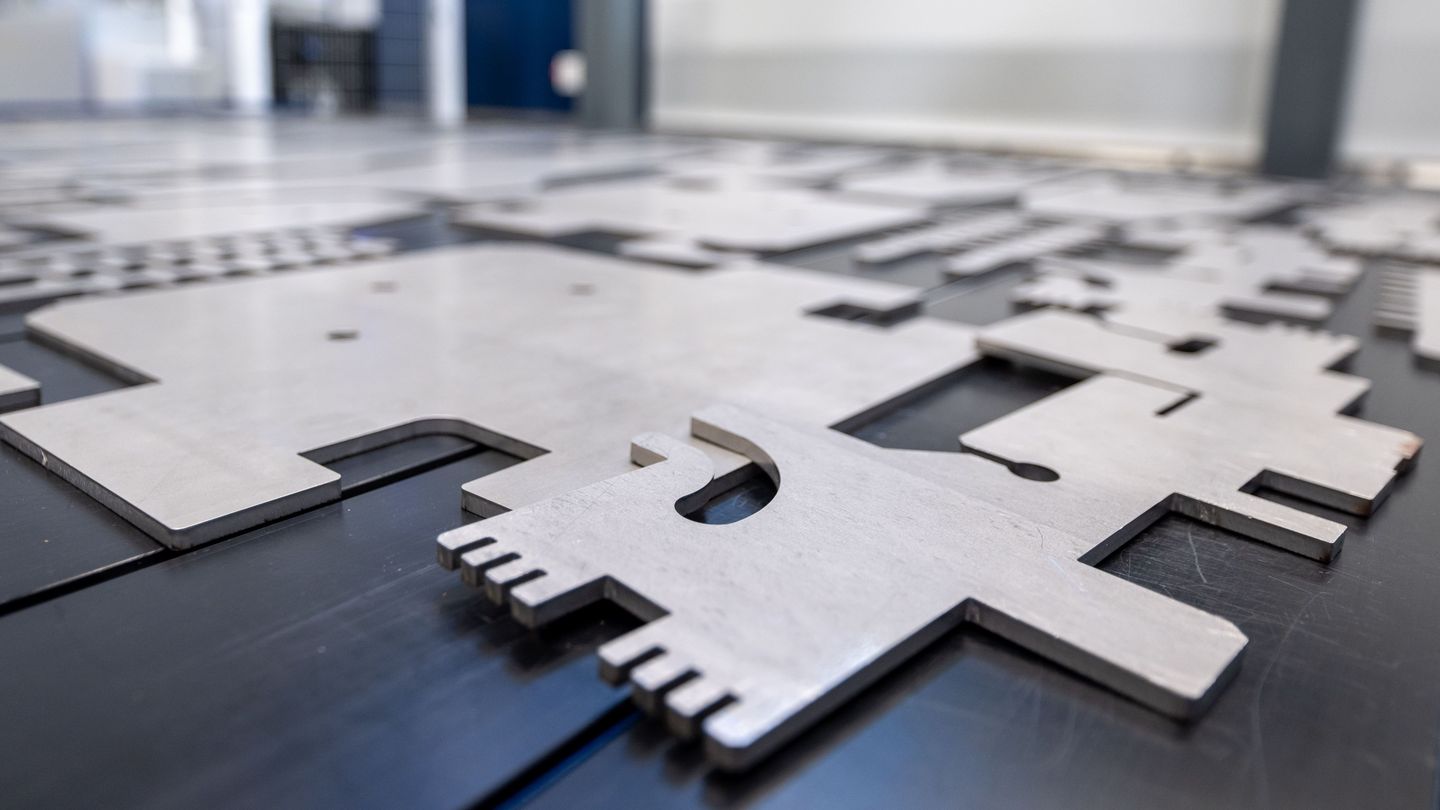

The process creates maximum flexibility and capability to handle a wide range of parts and batch sizes. In particular, the system can accommodate small or complex parts that are prone to tipping over or tilting in the scrap skeleton. Even thicker parts can be separated out and automatically sorted in the sorting process. The two sorting modules can also be retrofitted at a later date, which reduces the initial investment and allows the degree of automation to be increased step by step.
“This fully automatic solution for separating and sorting is a real gamechanger,” said Bunz. “Thanks to this innovative process, customers will be able to automatically sort parts that could not be removed using conventional solutions, even with a batch size of one.”

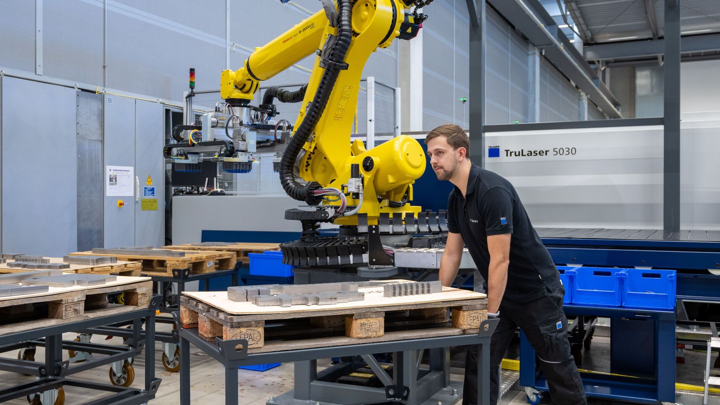

Finished and stacked
After automated sorting with the SortMaster Station and SortMaster Vision from TRUMPF, an employee just has to remove the finished stacks of parts. (Source: TRUMPF)
