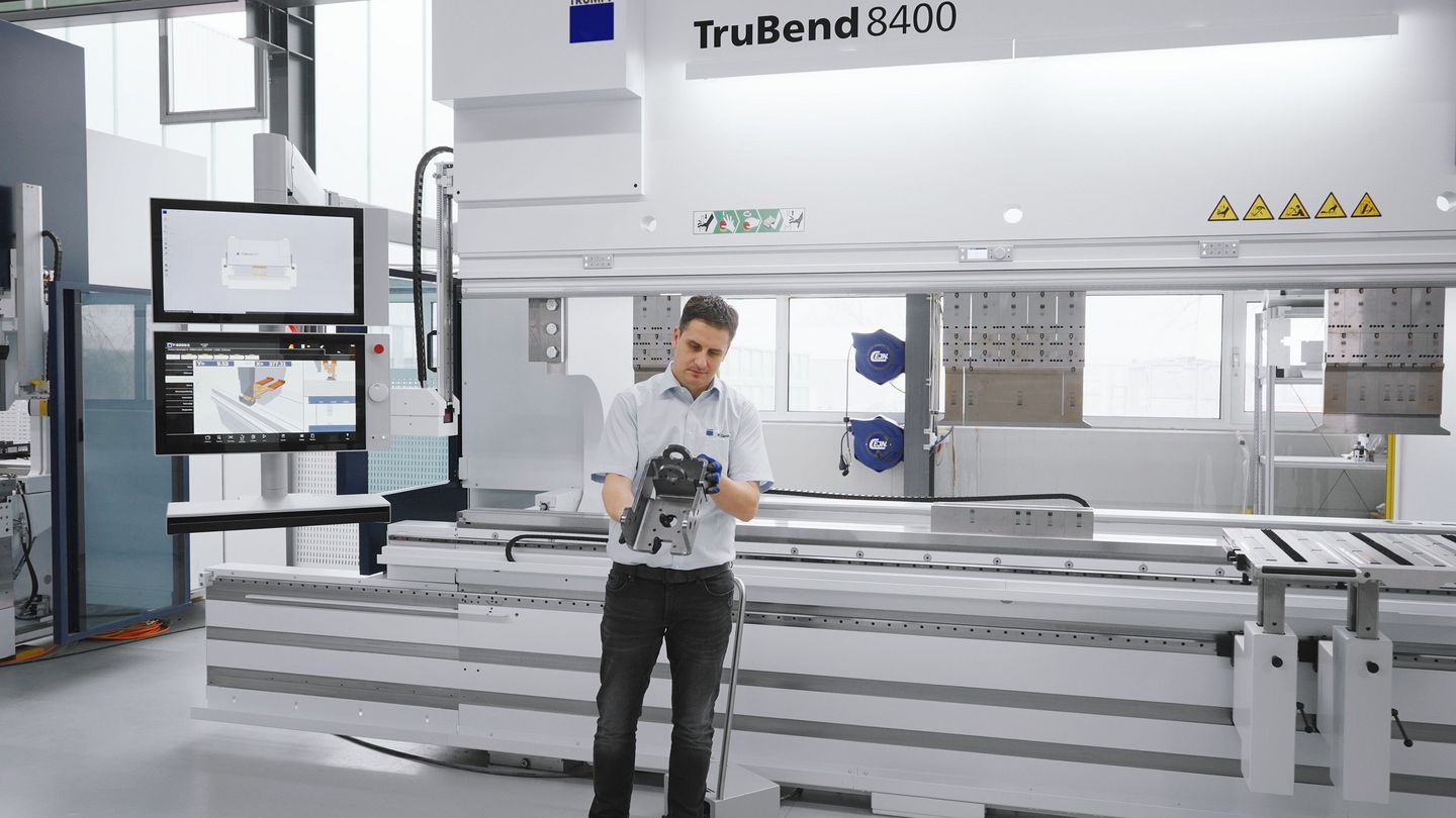

TruBend 8000
The new TruBend 8000 generation of machines from TRUMPF is particularly well-suited for bending large components or high sheet thicknesses. (Source: TRUMPF)

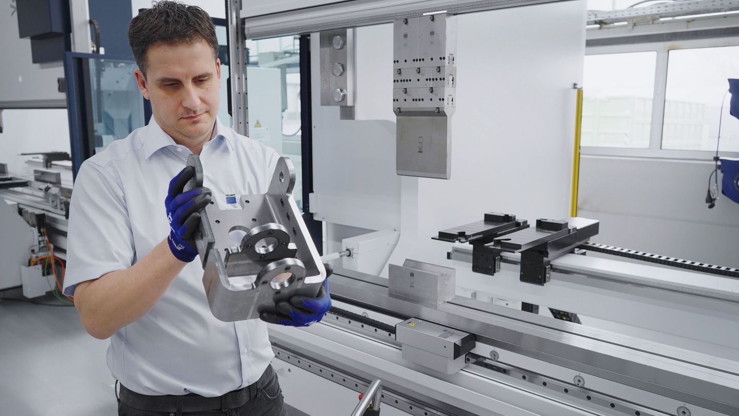

Hard Materials
With a press force of 440 tons, the TruBend 8000 from TRUMPF bends high-strength steels with ease. (Source: TRUMPF)
