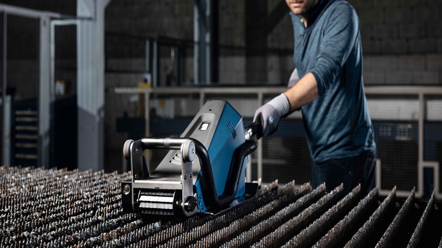

TRUMPF TruTool TSC 200 Slat Cleaner
Equipped with new technology, the TruTool TSC 200 can also easily remove hard slag from slats, which can form when using powerful fiber lasers. (Source: TRUMPF)

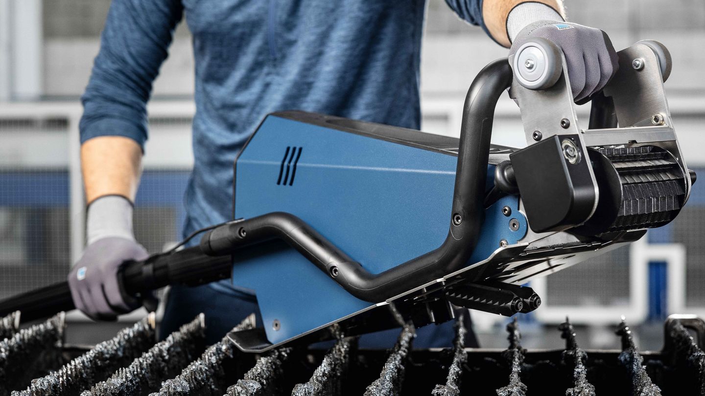

Simpler, ergonomic Design
TRUMPF's new TruTool TSC 200 slat cleaner is equipped with a 1,700-watt motor and customized gearbox. An integrated slipping clutch protects the motor from overload. (Source: TRUMPF)
Closeup of Cleaning Tools
The cleaning tools use a roughing/finishing principle. Serrated cutting edges break up the slag, then a continuous cutting edge scrapes off the slag. (Source: TRUMPF)
