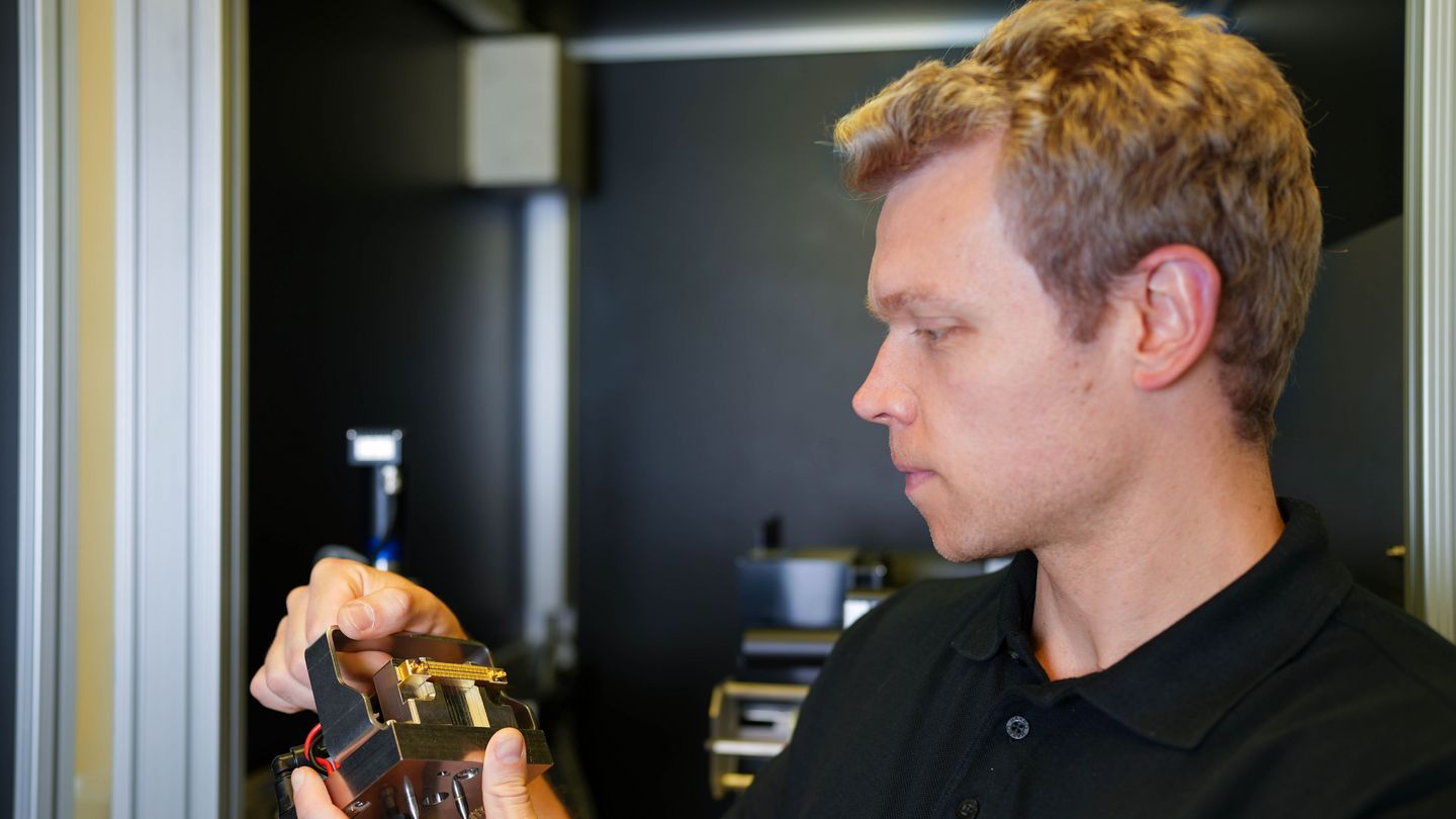

VCSEL-based heating systems made in Germany
TRUMPF designs and manufactures its VCSEL-based heating systems in Germany.
