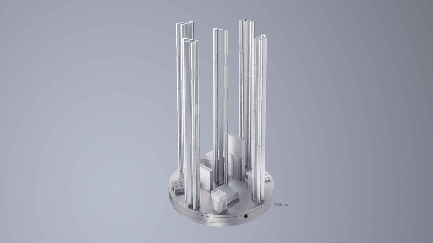

Component from the R&D field
During application or parameter development, the build job shown is used. In doing so, the long rods are processed to form tensile test specimens after they have been cut from the substrate plate.  They can be used to inspect the strength and deformability of the component. After cutting and grinding, the other square components  are checked for potential fine defects under the microscope. In both cases, this is in order to assure the quality of the components.
