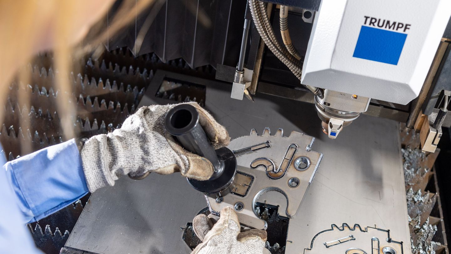

A worker inspects a part after creating bevels using TRUMPF EdgeLine Bevel technology. (Source: TRUMPF / Martin Stollberg)

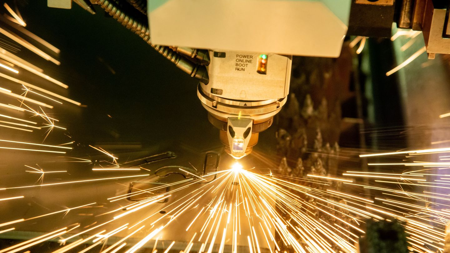

EdgeLine Bevel technology allows standard TRUMPF laser-cutting machines to apply slanted edges to the contours of a part in a process known as beveling. (Source: TRUMPF / Martin Stollberg)

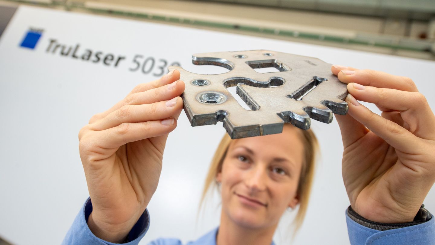

A worker removes a beveled part from an off-the-shelf TRUMPF laser-cutting system.
