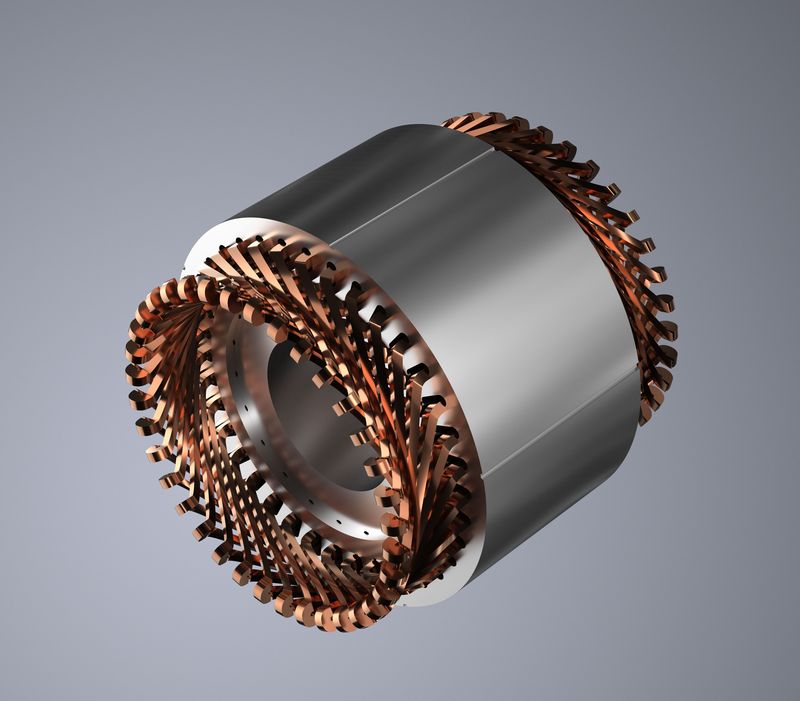

TRUMPF Anwendung Powertrain Stator
Ablation/paint stripping
TRUMPF lasers remove functional layers to achieve a clean surface for welding or adhesive bonding, without affecting the base material. In order to prepare hairpin welding, for example, our customers use TRUMPF short-pulse lasers that ablate the layer of insulating paint, without damaging the copper underneath it. While welding the hairpins, an intelligent sensor system ensures precise seams and top quality. TRUMPF lasers are also used to strip cataphoretic paint or zinc coatings.
