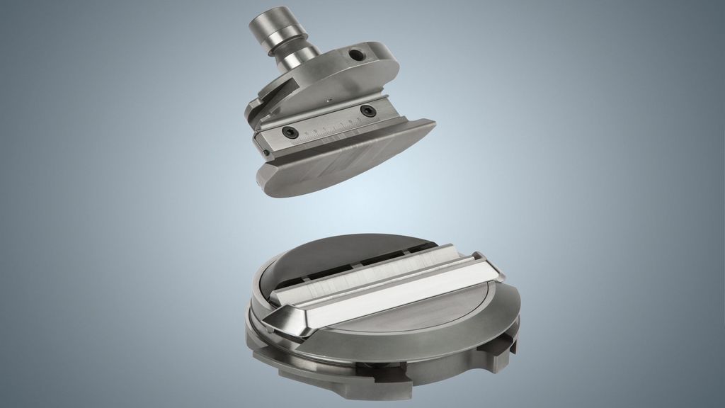

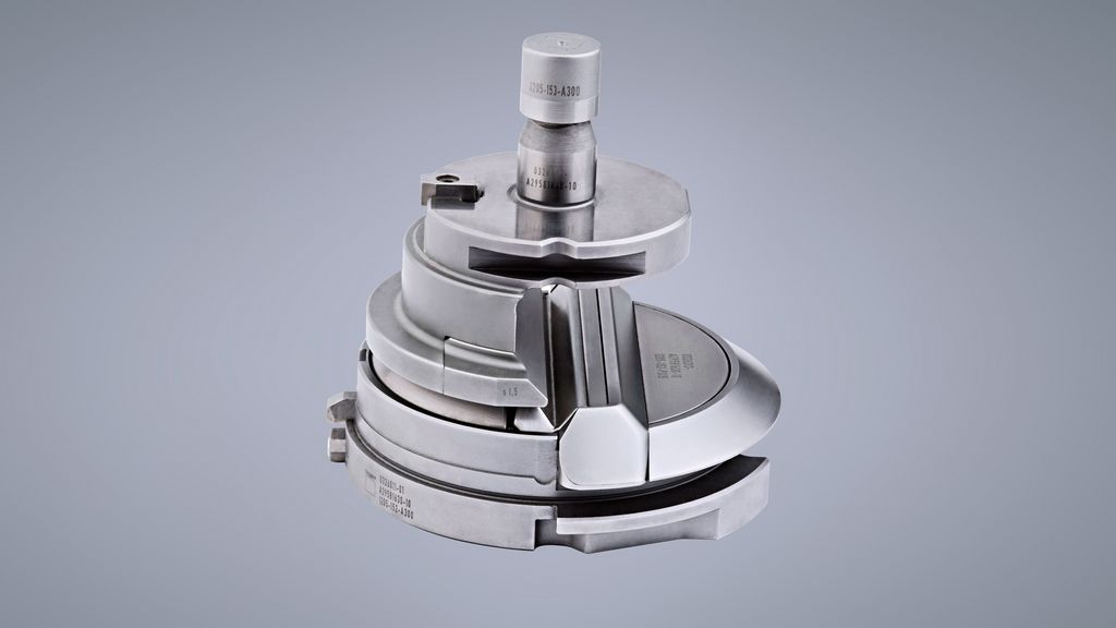

With the MultiBend tool you can form small bends on your punching or punch laser machine directly. Here, you can create a bending angle of up to 90°. Due to the complete processing on one machine, you can reduce your part costs and increase your productivity considerably through the fast bending operation.
In one operation
Lower your part costs by reducing downstream work steps.
Fast bending
High productivity due to faster bending operations
High accuracy
Due to the exact positioning of the workpiece, you can achieve high precision.
Mark-free bending
Mark-free bends are created due to the use of a bending roller in the die.
MultiBend
Bending and punching in one operation: The MultiBend tool enables the forming of small bends with a width of 55 mm maximum and a side length of up to 25 mm. A bending angle of up to 90° can be created. In this way, you can produce door locks or lock cases or brackets directly on your punching or punch laser machine, with high productivity and precision. Due to the complete processing on one machine, your machine utilisation rate is increased and you can reduce your part costs. As a result of the bending roller in the die, you can also achieve mark-free edges.
