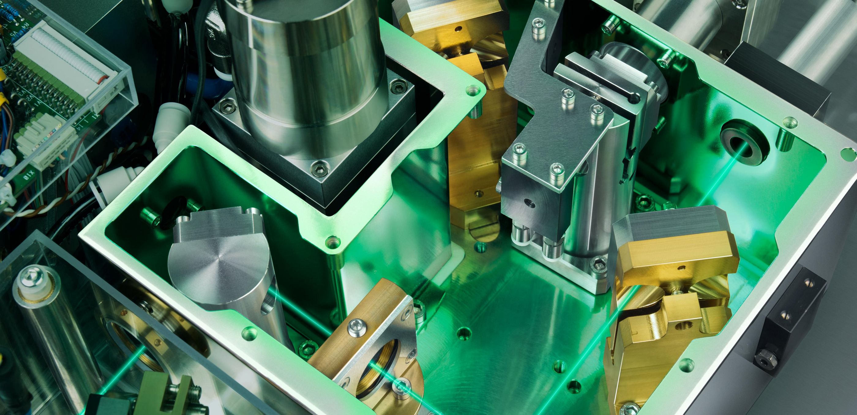

Internal frequency doubling in the resonator of the TruDisk Pulse
Pulsed laser
TruDisk Pulse
Internal frequency doubling to produce the green laser light
