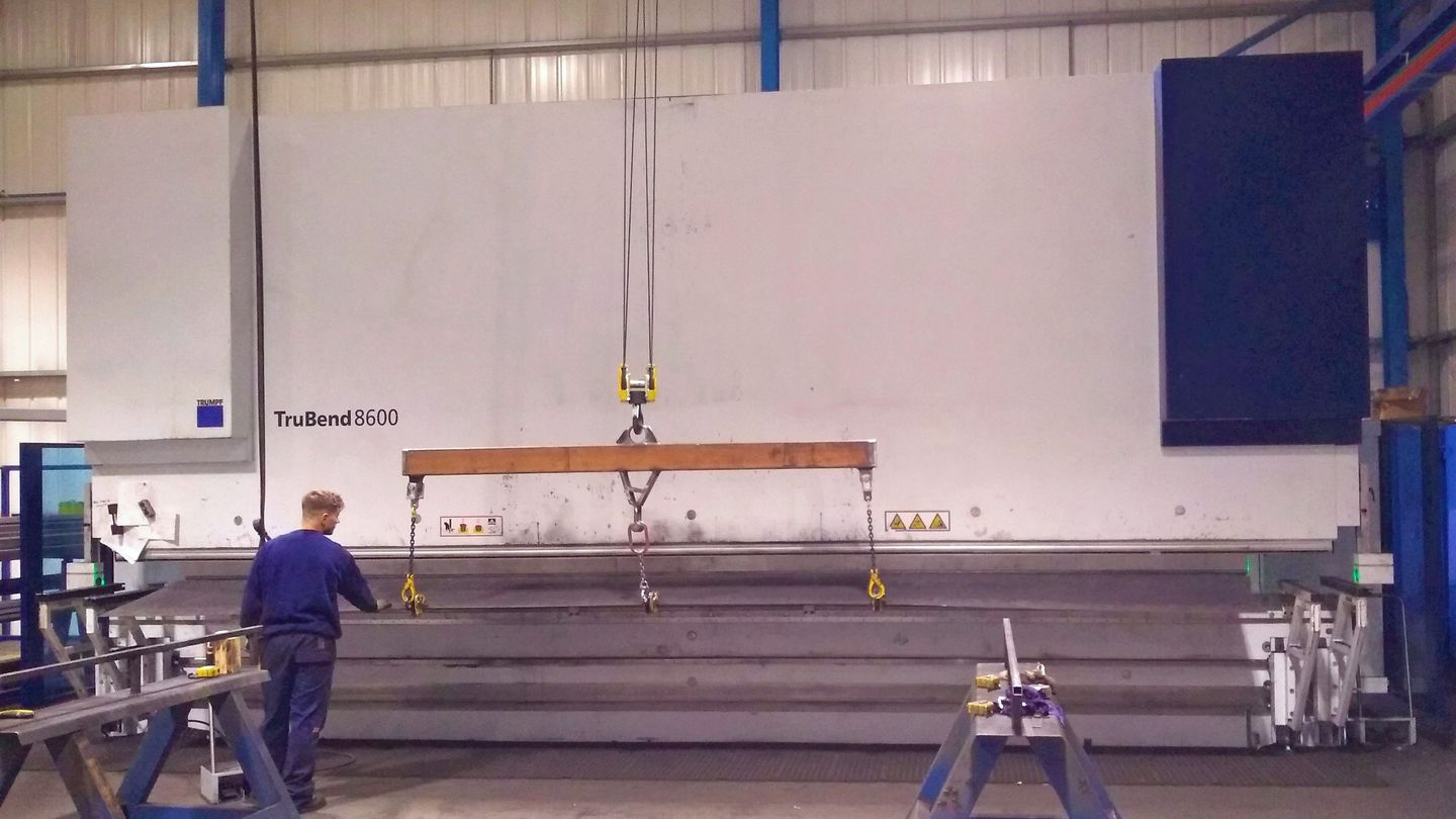

The Thompsons Group, the UK’s number one manufacturer of tipper bodies, has taken delivery of a TRUMPF TruBend 8600-80 bending machine at its Blackburn facility. The machine, which is the largest TRUMPF TruBend in the UK, is being used to form tipper side panels from 4mm thick Hardox® abrasion-resistant steel. .

The TRUMPF TruBend 8600-80 impresses not just with its precise versatility, but its large open height, throat depth and press force. Users can process particularly large and heavy parts. Thompsons’ TruBend 8600-60 offers a 600 tonne press force, and to fulfil the customers’ requirements TRUMPF customised the machine with an additional 8m bending length option.
“After profiling, the side panels of the tipper bodies each require up to 12 bends, which is where the tonnage of the TRUMPF TruBend 8600-80 really comes into its own,” says Mr Griffin. “Having capability of this type in-house is a real market advantage as we don’t have to rely on subcontractors, and thus avoid all the associated costs and lead-time issues that strategy brings. Moreover, all Thompsons’ tipper bodies are manufactured specifically for each customer, who can specify the height, length and width of the tipper bodies they require. As we manufacture in-house, meeting these needs could not be simpler.”
Thompsons manufactures circa 25 Hardox® tipper bodies on a weekly basis, which means 50 sides to bend, plus floors and tailgates. The new TRUMPF TruBend 8600-80, located at the Blackburn factory, is currently working a single day shift but a night shift maybe required to keep up with demand.
“Having the higher tonnage machine makes light work of the Hardox® panels,” reports Mr Griffin. “In addition, the machine is more accurate than our existing press brake. As a company, we are always looking to improve and innovate, so machines such as the TRUMPF TruBend 8600-80 serve to future-proof our business.”
