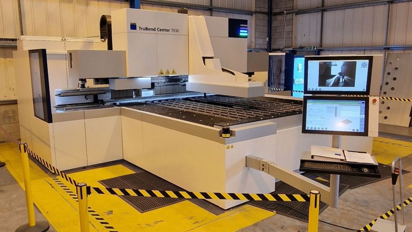

Metalline, a leading UK manufacturer of architectural metalwork solutions, has invested in a fully automated TRUMPF TruBend Center 7030.
Metalline, a leading UK manufacturer of architectural metalwork solutions, has invested in a fully automated TRUMPF TruBend Center 7030. The machine, the first panel bender on site, is providing three times the throughput speed of the company’s press brakes and helping this progressive business to continue its impressive growth trajectory.

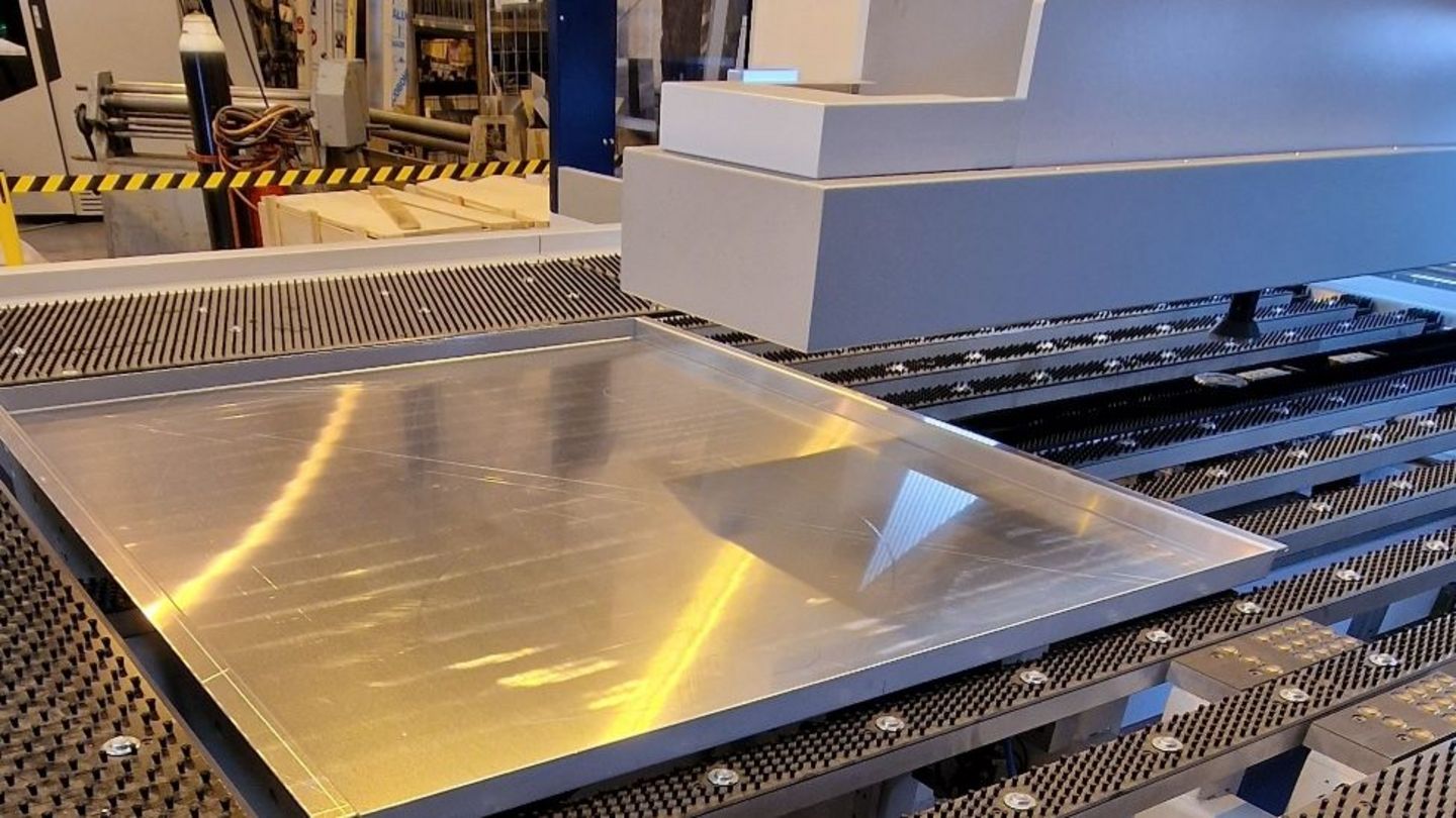

The fully automated TruBend Center 7030 panel bender arrived in March 2022 and is now busy manufacturing aluminium sheet into rainscreen panels and tray panels. Current batch sizes are around 400-600.

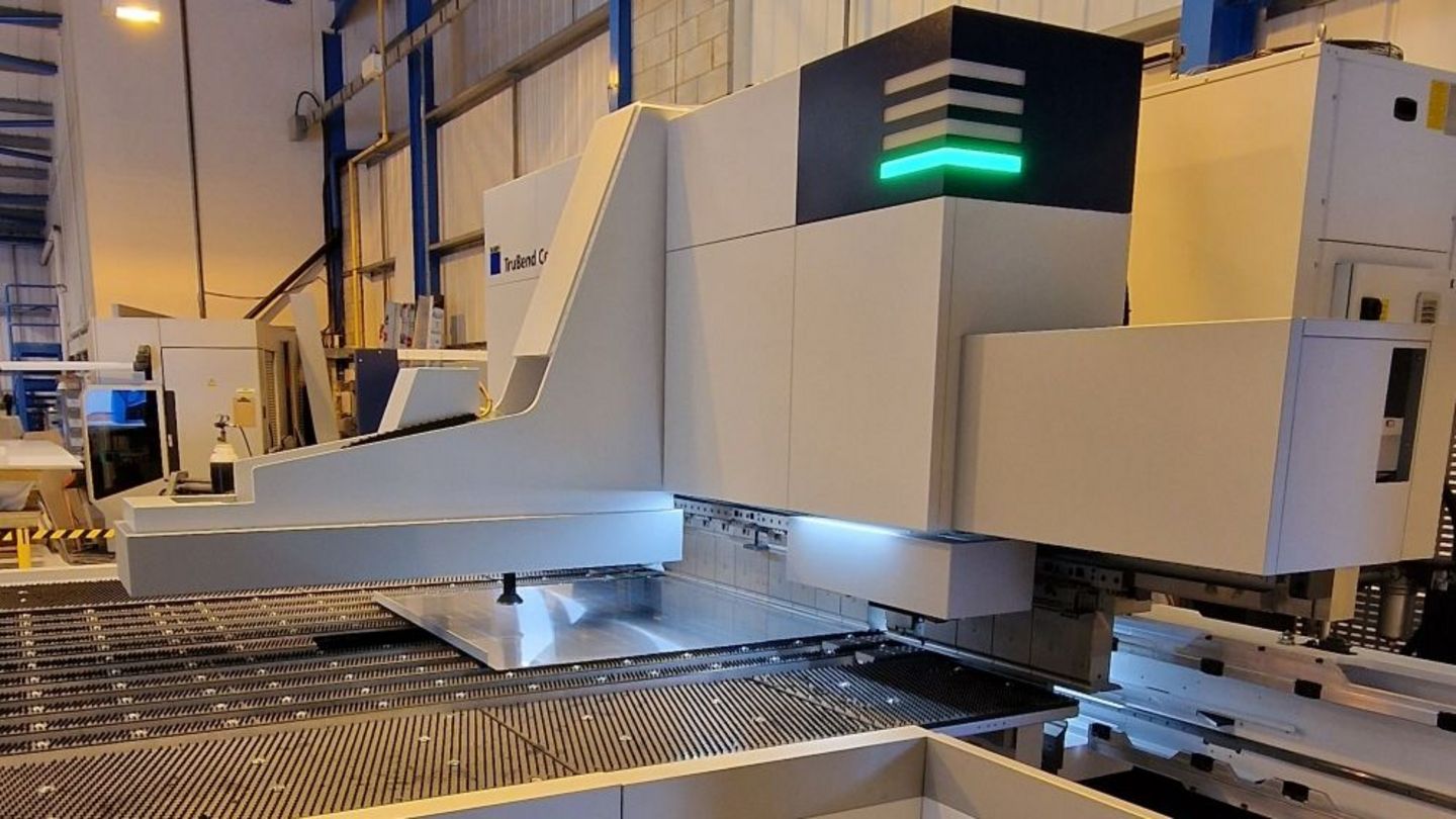

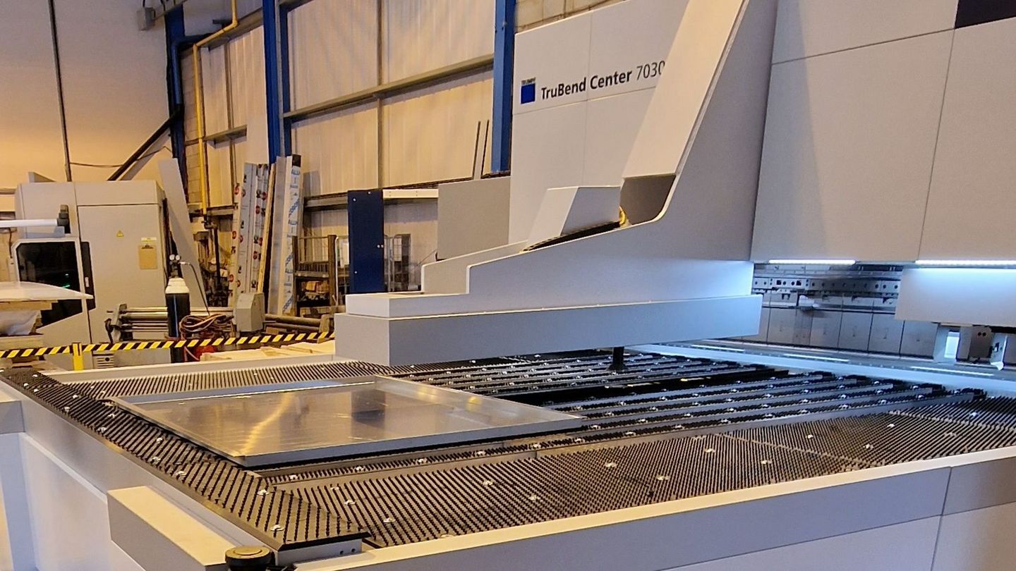

The TRUMPF TruBend Center 7030 features a two-axis part manipulator that positions the sheet and even enables negative bends. Complementing this is a rotary part manipulator that secures the blank and rotates it to the required position completely independently.
“We really like the offline programming software, which is really quick,” says Mr Hoult. “However, we also like the fact that we can program the machine online if needed. As a result, we don’t have to wait for a programmer, the operator can get us up and running.”
Another impressive feature of the machine is its ACB laser technology, which ensures precise angles for a first part/perfect part approach. According to Mr Hoult, this measuring device has “made a big difference”. However, the biggest differentiator between panel bender and press brake technology is surely speed, something that has not gone unnoticed at Metalline.
