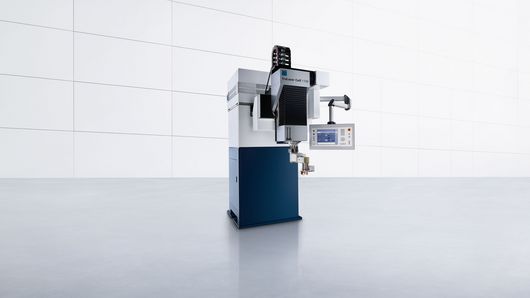

TruLaser Cell Series 1000, cost-effective laser tube welding
If you don't just want to cut your tubes and profiles, but need to weld them as well, look no further than our specially developed TruLaser Cell Series 1000 laser welding system.
