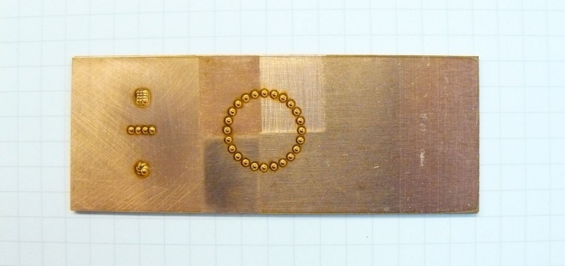

Regardless of whether the surface is oxidized, ground, sandblasted, rough, or polished to a high gloss, a green laser beam makes it possible to create welding seams in copper which are always of uniform quality.

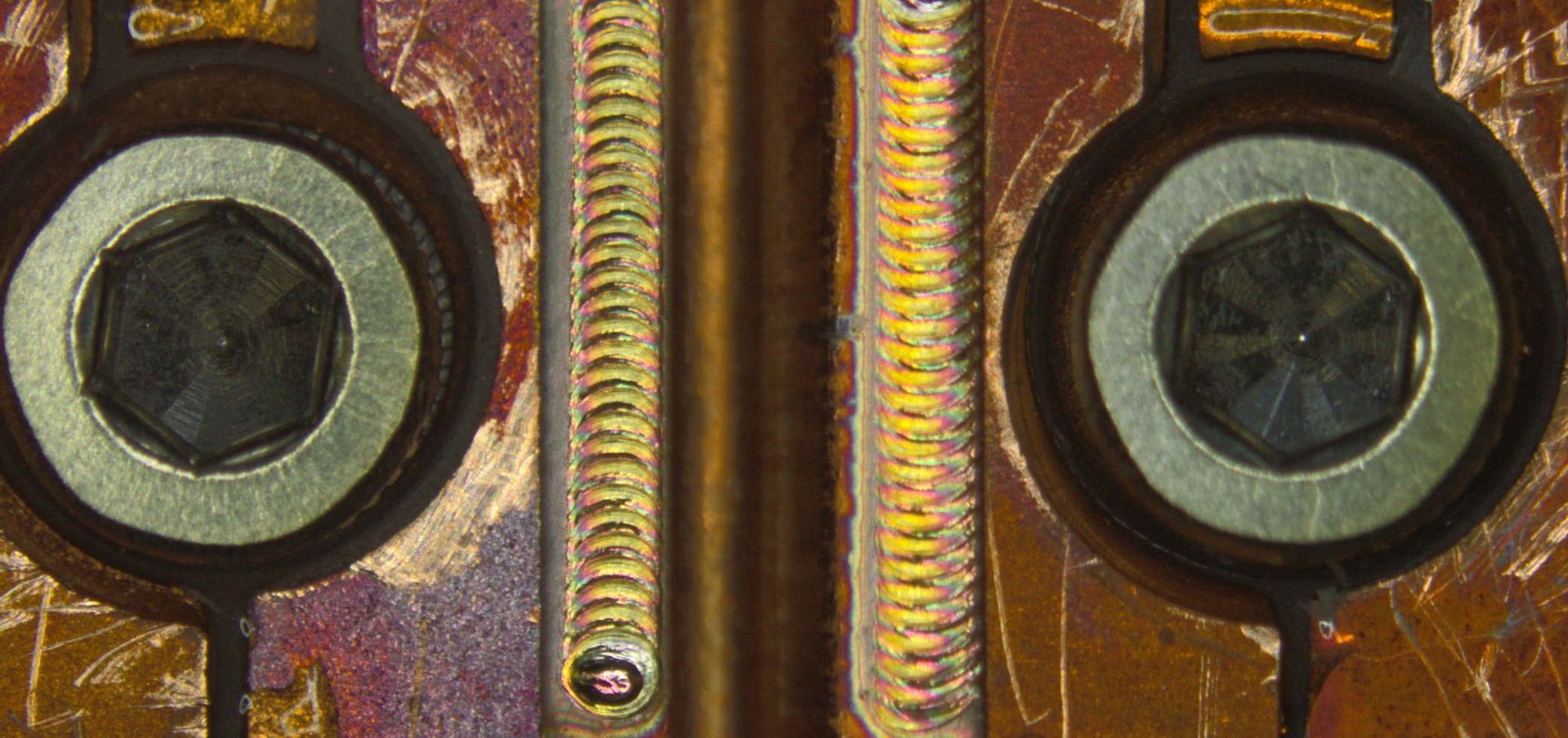

The uniformity of the welding depth when using the TruDisk 421 pulse makes it possible to weld thin materials on a difficult substrate. Shown in the illustration: Two copper layers of differing thicknesses (0.2 and 0.3 millimeters) are welded without damaging the ceramic material lying below.
